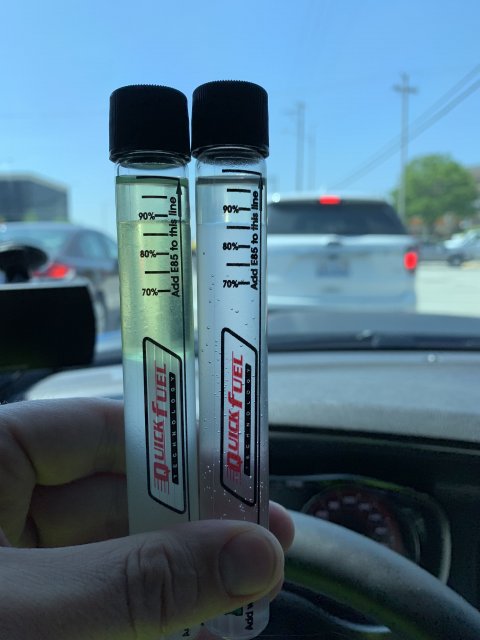

I've been on pump e85 for 12,000 miles straight. I probably have 200 + WOT pulls on it as well. Every single tank I put in is tested to verify content. Especially when I've had first hand experience of a tank getting "misfilled" with garbage. Too much at risk to get lazy.
Having a content gauge does you no good. You fill your tank with e70 hoping for e85...now what? Drive it all out. If you look at the fuel and test it for the minute that it takes before hand, you know what you have on hand. It isn't difficult at all. Owners with these setups need to be responsible if they want this power level and want to use "pump" e85.
I'm not testing mine and haven't been for 16k miles. The E85 would have to be EXTREMELY poor content for mine to be an issue. Even 30% ethanol has an octane rating of about 97-98 which is enough for my setup. Now for those that are running more extreme setups like a 2.50 or 2.40 pulley and/or lower also, your octane needs are a lot higher so you would most likely need at least 60% ethanol. I stayed conservative with my pulley setup. 2.65 is only slight more aggressive than 2.85 so I can get away with just about any blend of ethanol as long as its at least 30% or better. That being said, the two stations I get my E85 from, have always been at least 75% ethanol everytime I've checked it with HP Tuners.
Here is why you test.....I alone was the reason a gas station had to have their tank emptied, cleaned, and refilled. Guys could of had huge issues if this wasn’t caught, especially considering so many blindly fill jugs there for racing.
