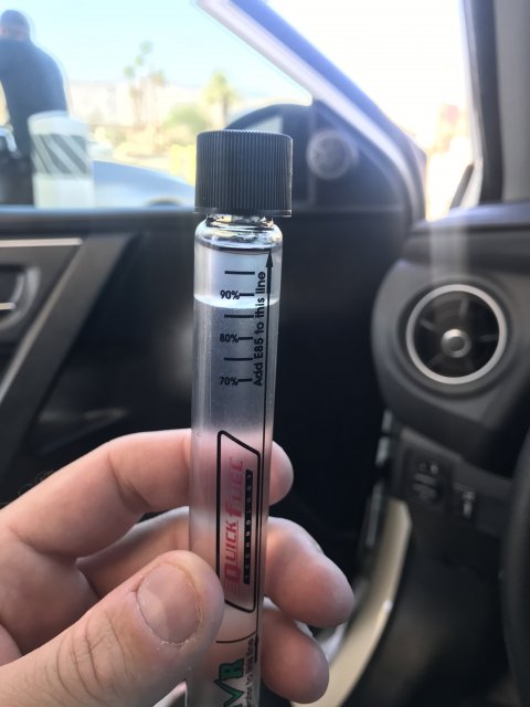

43C30AA4-B8E9-4CA3-BEC1-DD8B9555FC2B.jpeg I test at the pump every few weeks. I’ve been very lucky. E-85-90 every time.

View attachment 3434 I test at the pump every few weeks. I’ve been very lucky. E-85-90 every time.
Just gotta be a little careful. I’ve found multiple brands of testers generally run a little high. As much as 8-10% in fact. My Quick Fuel tester would consistently run about 8pts high compared to what one of my others does. It’s one my local dyno shop sells and it’s spot on with HPTuners.
Your fuel is still testing high enough not to matter but just in case you weren’t aware, they can be a little off.
