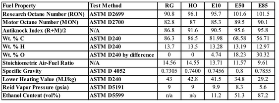

I did find an interesting chart that compares E50 with E85.
No idea how accurate the data is.
I always thought e85 burns faster than E10. According to the specific gravity in this chart it is a heavier fuel and burns slower. I have to research that. So that is correct on the specific gravity. There are other factors above my knowledge that makes e85 burn faster than premium e10.
I did some reading on fuel years ago (I think HOTROD mag) and don't even remember most of it. It was when E10 was coming online and was going to be the new norm for standard petro at the pump in the country. Even back then they randomly checked a bunch of gas stations in CA and the range was from 15%-30% ethanol. Only a few had true 10%. I can't remember what was more significant, RON or MON. I think it was MON but no one uses it. I also remember back then E10 was reeking havoc. Aluminum gas tanks(Boats) corroding like crazy and eating up rubber fuel lines and needle seats in carburetors (remember those.LOL) and that was just E10!.
The most useful info in my limited knowledge I could gather is that it looks like on average you have to run @43% more E85 to get the same stoichiometric AFR as E10. Don't even know what RG and HO (heating oil?) are?
Not sure on accuracy, I've read in other places that 85% ethanol is actually closer to 105 RON. That being said, you can see that even E50 has a significant advantage over 93 pump gas and is quite a bit cheaper than 100+ octane race gas.
