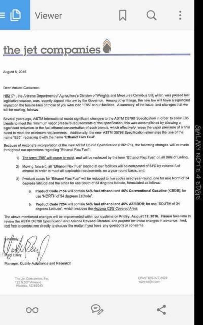

If I remember correctly from the forum we migrated from, you're in AZ correct?
Be careful because AZ pumps are "flex fuel" not true E85. ethanol content 54% year round so they don't have to mess with seasonal blends.
Once I get mine converted to ethanol I plan on running the flex fuel mixed with some torco race e98. When its track time and kill mode I'll run pure e98 from torco..
OK. That convinces me that switching is not going to happen. If you can't even trust the pump sign that specifically says E85, then screw it.
True E85 is flex fuel also.

Even 54% ethanol would have a significantly higher knock resistance than 93 gas.
#1305
56
61
Gilbert
It is, but arizona is retarded about ethanol fuels

Let me see if I can make some sense of this. If “flex fuel” in Arizona is a regulated 54% then that is as reliable as the 91 octane rating in their premium pump gas. Arizona is saying that that is what is going to be in those pumps year round and it is not going to vary. Remember that you can not test pump gas to see what you’re getting. 91 octane? There have been cases when it was not. So the question is.... what’s better if you are just going to trust what’s coming outta the pump. E54 or 91? If you want to make more power... talk to a knowledgeable ethanol tuner about what he can do with the e54 vs a 91 pump tune. I’m going to bet that he’ll tell you that you can safely make much more power on the e54 than 91. If you already have the pumps to deliver the volume and you change to the bigger injectors then you can either do a flex tune or two separate e tunes. One for 54 and one for 85. You can buy Torco 85 by the drum or fill jugs for the occasion you want to go to the track. My shop there in Phoenix sells it for around $6 a gallon.
