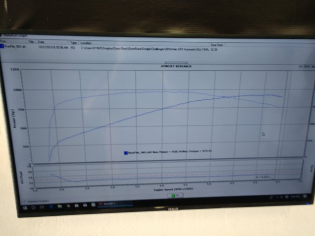

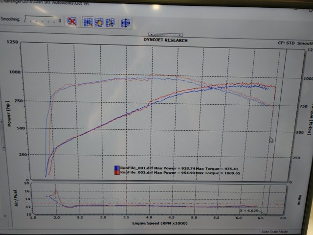

At Dyno now. After two hours of driving it did 929/975. It pulled timing. Iats hot .Lots of torque.

A little cool down with e85. 955/1010

What pulley setup and A8 or M6? I see STD correction was used which is going to rate higher than SAE.

A8- 2.5 pulley

Lol. Only 15 pounds of boost. Stroker. Supercharger is too small. Horsepower starts dropping after 6200 rpm. Maybe it is spinning. As the torque was not a blip. It was a strong 1010 over a nice range.
Eh. 15lbs of boost that's acceptable. I'll let ya slide this time but try and get serious will ya'. :LOL:
Ah ok, stroker and 2.50 pulley. That explains the 1010 torque, those extra cubes!

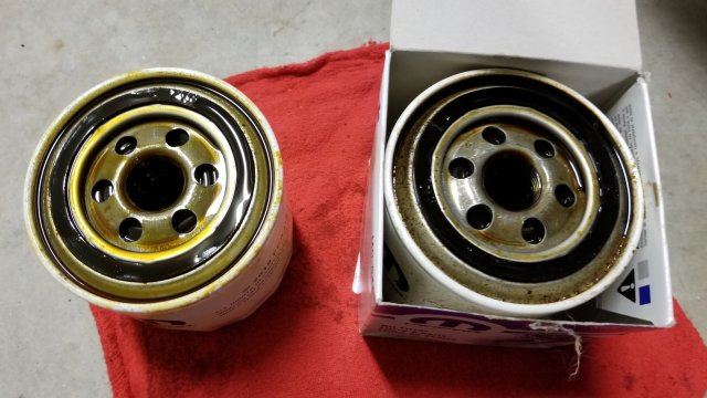

I was advised to change oil every 3K on E85 so I stick to that and I don't think the amount of time between oil changes matters nearly as much, its really about potential oil contamination which comes from mileage. I've been running E85 primarily for the last 14K miles since my car is a daily driver. I've had my oil tested twice at Blackstone Labs and both times the wear results have been normal. I even went 4K miles on one sample since I got behind on my oil change schedule and the oil sample was still normal. I'm due to change my oil again this upcoming weekend and I will send a third sample to Blackstone so we'll see what this one shows. I missed sending a sample on my previous oil change because I forgot to order more oil sample containers.
Here's a cool picture I posted on the other forum months ago after changing the oil in my car and my wife's Hellcat on the same day. Mine had 3K miles on the oil change (left), my wife's had about 4K miles on her oil change (right) but you can clearly see how much cleaner burning E85 is and its affect on the oil. My oil still looked very clean, my wife's Hellcat which only runs 93 octane looked black which is typically what you see on pump gas engines.

All great info. I was at Napa auto supply here locally and on a related oil filter note they told me the mopar filter which is recommended has a 16lb spring in it, and the viper filter (SRT filter some use) has a 12lb spring in it. I'm going to run Schaffers oil now that it's made in 0W-40 (lots of my racer buddies love it) with a Napa gold filter (wix filter) part# 7899 which is equivalent to the Mopar filter (recommend in manual). I found it interesting that the filters have different spring rates though.
That oil looks much cleaner with E85. I'm trying to think of any single reason NOT to run E85, lol. Figure as long as I know the alcohol percentage it should be all good. The benefits seem to outweigh the drawbacks.
