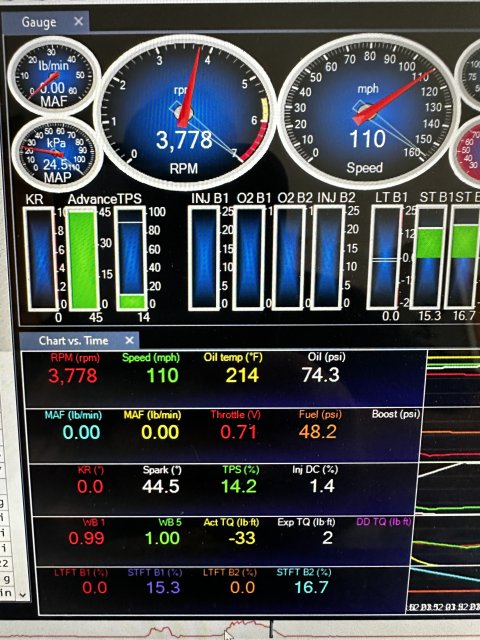

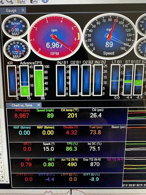

#69
I know I change my oil every couple weeks. Mine on a pass I have low oil pressure threw 3 gears down as low as 29. When it pick back up it’s over IMG_6462.jpeg IMG_6461.jpeg 90.
So I can also tell you this my Buick with a rear sump when I throw the chute loss oil pressure on deceleration. I know I pulled the bearing on mine and still look great. I do use VR1 20w50.

Thread Starter #71
I know I change my oil every couple weeks. Mine on a pass I have low oil pressure threw 3 gears down as low as 29. When it pick back up it’s over View attachment 109842 View attachment 109843 90.
7qts? Interesting about the rear sump pressure dropping on decel which makes sense - front sump you should gain oil pressure on decel
