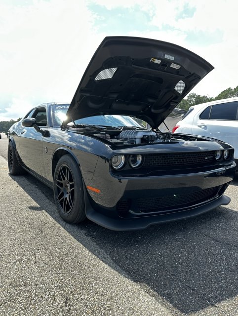

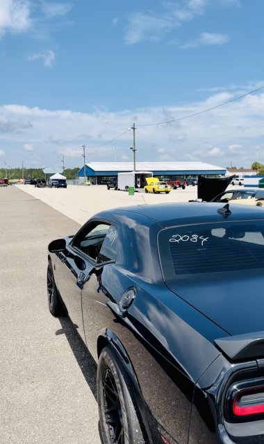

Went to track today, 3000 DA 😅😅, ran my worst 60’ ever, and 1 10th slower. 3.70 id going back in you guys are nuts with the 3.09 not enough gear. Locked myself out of laptop, no way to unlock it, so couldn’t data log or try two other tunes I have with more timing for the launch. Bit disappointing, but didn’t break anything. There were literally 10 cars, could have really dialed the car in with the other tunes. What a shame.

Maybe the 7th quart of oil slowed me down? Back to 6.5 😉
