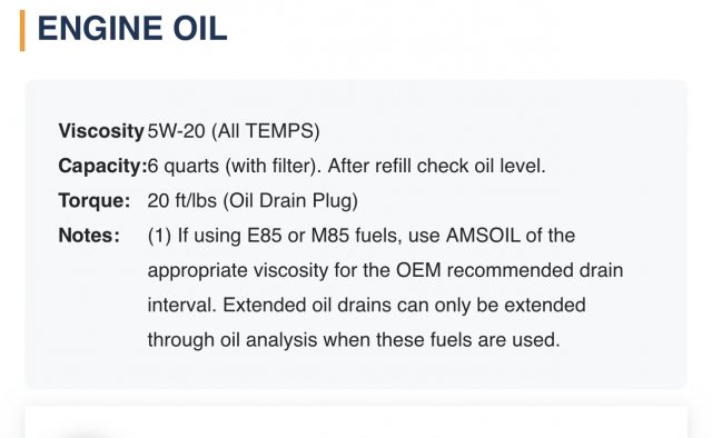

The v6 flex fuel cars all call for a heavier weight, and it’s due to the e85

I’ll see if I can find it again, it was mentioned in length for the charger interceptor upfitter package for maintenance. This is from amsoil for the charger flex fuel (factory recommended weight)
