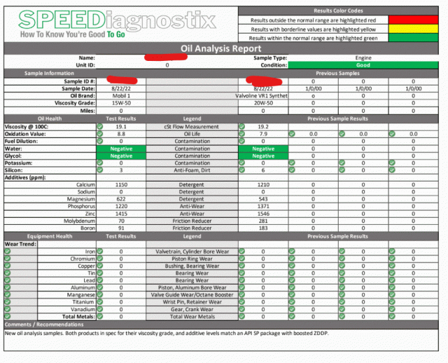

That's interesting. I've sent two oil analysis from my car off to Blackstone when running E85 just to see if anything was different, and no change in fuel dilution, water content, or anything else. I DID learn that running leaded race gas causes lead to build up in the oil though. I had run a few gallons (not many) of Renegade 110 (leaded) mixed with Renegade RM109 (unleaded) and the lead from the race fuel showed up in the analysis. Blackstone said it wasn't a big deal as long as you know where the lead is coming from and said older cars that run leaded fuel or a lead additive have lead readings in the thousands, mine was about 100ppm. It's now gone after a couple oil changes though since I started using E85 exclusively at the track.
I don’t run anything but e85, that might be it. Change it every 2-3k miles unless I’m racing. I’ll send a sample to black stone and my filter next change

I run E80-85 100% of the time. I send my oil out to Blackstone for analysis and it never comes back with fuel in the oil but I do notice the longer I run the oil my oil pressure drops about 5 psi at WOR, change the oil and it back up to 70-72 psi at WOT (maybe 1000 hard mikes on the oil) Something is thinning it out. Blackstone oil tests do not show a viscosity problem either. This next oil change I’m going to try Mobil 1 15W50 verses the 5W50 Amsoil Signature Synthetic I’ve been running. Mobil 1 15W50 tests very close to Valvoline VR 20W50 at 100 C but has better cold start flow abilities as the VR is like syrup when cold.
