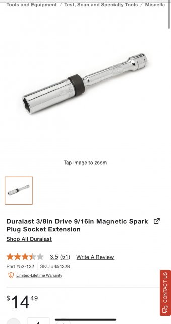

I guess the part number on the socket isn’t correct but this is exactly what it looks like (I know this one is the wrong size). You can put a socket wrench right on it and get them out without any additional extensions, maybe a 1” once on top of it for the back ones. Get this in 5/6. The magnetic part is amazing. Some of my best tools are duralast

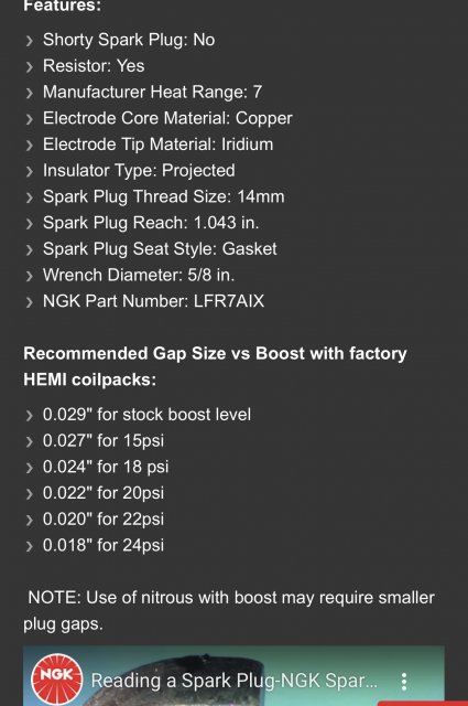

Hmm according to HHP by gap might be too big?

This would be why you may want to pull the plugs and at least check the gap.
Taken from a post from 170 facebook page
"All plug removed had a gap between .033 1/2 - .036 with most between .034-.035."

Wider gap is for fuel economy but you will get spark blowout

Yeah, thinking I need to close up the gaps. I’m around 17 lbs of boost

I use 2309’s gapped to .018”, I see very few miss fires recorded, none during WOT periods. Cylinder 8 seems to have the most, seems that way in allot of logs I’ve looked at not just mine.
