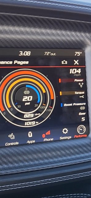

Yes but never read 4 digit hp.

That display and the dyno line are my favorites. Nice power! Bet that felt good. Glad you are having fun with it. I am enjoying the thread.

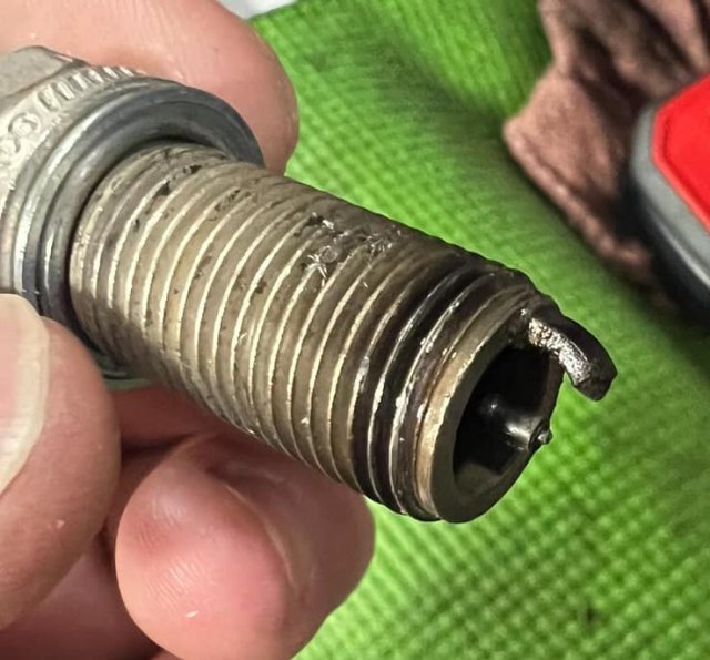

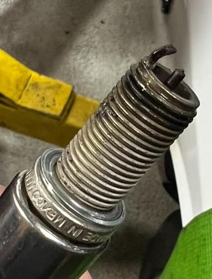

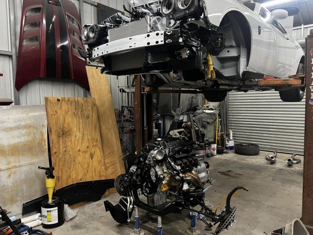

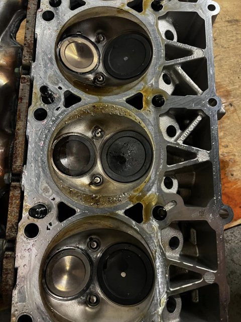

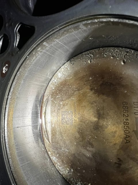

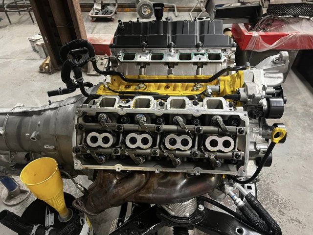

Here are some pics from the 170 spark plug failure. Dealer told the customer that there were no replacement parts available at this time and they couldn't give him a date when they would be available. Customer decided to fix it himself. Not sure what the hole story is but here are some pics.

well there's your problem. the gap is too wide. :p
8,756
7,682
So the customer ripped apart and paid for parts for a car under 5 years warranty lol ok. On the other hand, I’m glad he chose the easiest way to change the plugs (dropping the engine)
8,756
7,682
Must be a YouTuber or something I can’t see anyone doing that to a 170 makes zero sense
Makes plenty of sense:
option 1: dealer says, there's no available parts... meaning if left to the dealer it would likely sit out in their unsecured lot for /months/ waiting...
option 2: source the parts yourself and have it back on the road in a week or two, with it always parked securely and under your control.
He is not a youtuber and he has internal engine damage that's why he pulled the engine.
8,756
7,682
I guess, $125k car under warranty- I guess if i was rich I’d pull it apart. Not sure what they’ll say about future issues when it comes to warranty. Car didn’t have to sit there while waiting for parts/time
8,756
7,682
They replace the engine for internal engine damage, typically. They rarely open things up besides to confirm damage
Option 2: He also retains his numbers matching block which helps the value of his car; which he would not have if the engine was replaced under warranty. I believe this is a VIN matched 170 to his 2018; which he still owns.
