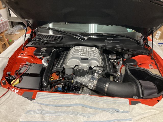

Yes, still stock valve covers. Just finished putting the worked over custom billet inlet plate equipped 2.7 blower back on. Hopefully get out for a test hit soon and dyno on the horizon.

Is that an afe intake??
3,828
9,073

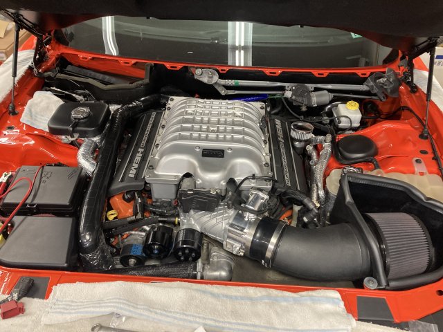

Whipple, it’s getting the right silicon coupler fitted tonight and the cowl parts put back on. It has one of my Pyro heat shields underneath it, which, by the way, I have about 10 or 15 to distribute if anybody wants any let me know

Man, I really like the way it fits and is all sealed up

What catch can is that?
3,828
9,073
Even better now with proper length coupling and doughnut gasket on the intake tube to box, totally sealed. The Pyrol shield keeps it all cool too.
UPR remote mount, their the best in my opinion, and I tried a few

Cool, I like how the hoses run under the coolant lines as I was wanting that because I have the ABS pump/lines cover too.

does yours have a maf sensor instead of the iat? My old junk does. Wonder if whipple will sell me just the intake

2016, yes, MAF sensor. Yes, they sell them, I’ve heard they want around $600 for the box, tube, coupler, seals, new hose and sensor mount for clean side PCV. They match up perfectly to the bottom air intake port as well, and the headlight intake tube too, nice fit. Mine came with a huge filter as well. Intake pipe is 125 mm on TB side and 7” on filter side. They’re trying to make up for losses on blowers with them. Lol.
