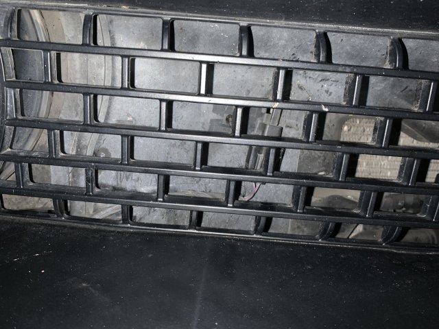

#78
On this episode of Ant's Garage, we troubleshoot V86 emissions snafu and see what the hell is really going on. So while the car is down, got it up on some jack stands, replaced the four bolt for the underside plastics, some plastic inserts, etc. Did a thorough inspection. Found my Ambient Air Temperature sensor just dangling at the bottom of the car. Fixed that:
Then I moved onto the subject at hand:
Either throttle body or the bypass valve. Start it with the intake off and watch the throttle body, see it if cycles.
So I have two videos, first startup and then a startup a minute later. As you can see there is some blow by past the throttle body when the car turns off. That whoosh sound echoes inside of the intake and the elbow and that's what makes the noise I believe (just a hypothesis, no way to test it for reals).
I hear a distinct whoosh of air hit that throttle body and it is not happy. Thoughts, comments, ideas? I'm still going back on Monday and getting a STAR report filed.
4,876
19,531
#79
