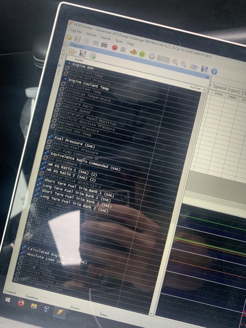

So I experienced that as well when I got home. I’m doing a read of the PCM to compare tunes.
4,062
10,147
things ive experienced so far, channels missing:
also the pcm is not recognized, had to select the pcm manually:
doing a read now and then grabbing some coffee and doing a comparison in vcm editor.

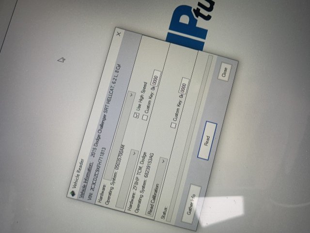

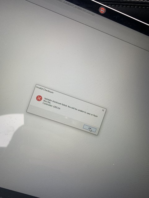

Went to do a read of the PCM/TCM as I have done before. I got this error message from HP Tuners.
Currently on the HPTuner forums looking for a solution.
