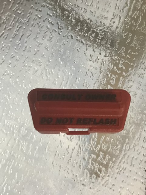

Ok, still on for Monday with NO PCM flash. I’ll get some pictures.
20,157
#50
Bob, folks are getting their tuned PCMs over-written at the dealer?
4,822
25,540
Thread Starter #51
Never ever let them flash your tuned PCM. I even fire a warning shot.
