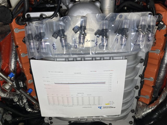

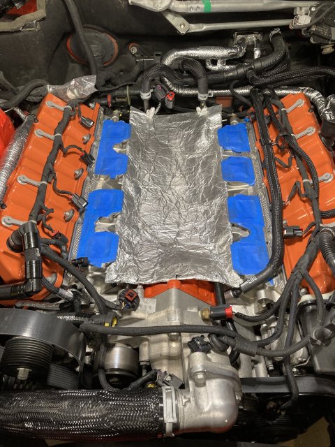

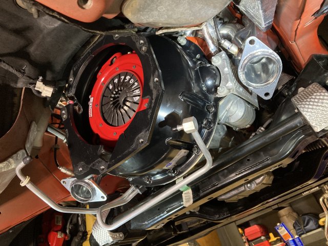

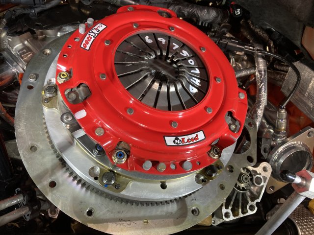

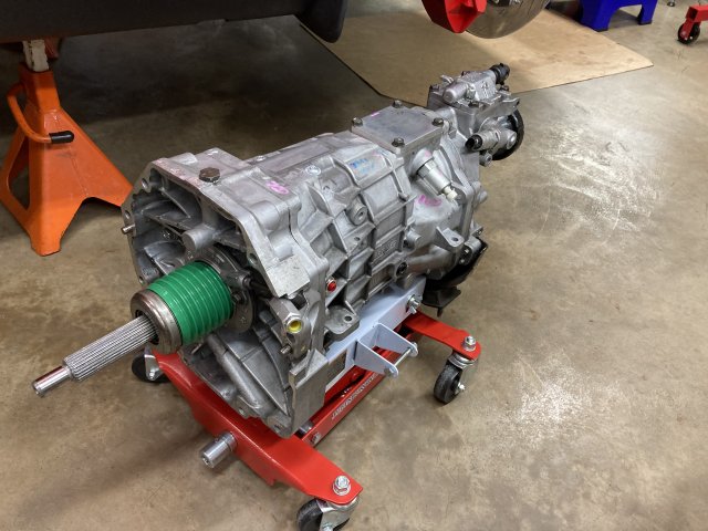

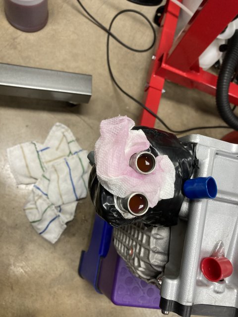

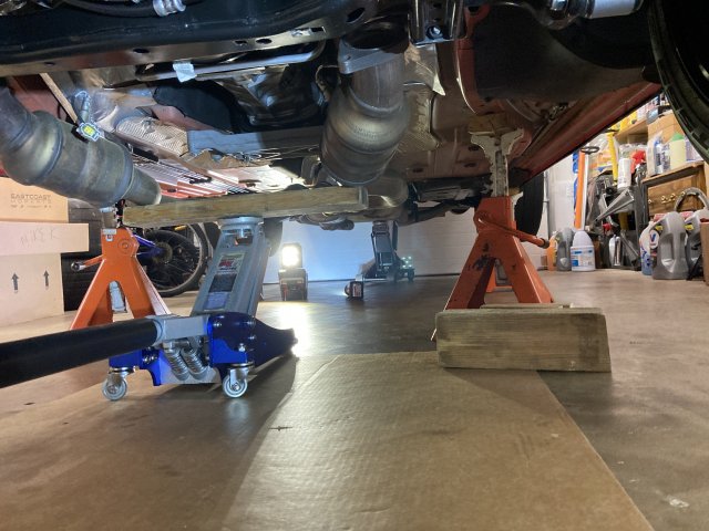

Ready for trans then DS, exhaust system and I’m about done under here. Hoping to wrap up tomorrow that, blower installation, fuel swap back to gasoline for start up, she’s full to the brim with E85 so have to pump her dry and refill with 10 gallons of 93, 0A2EF920-C927-4154-9594-B79AF6F20F25.jpeg D350F7AB-157B-448C-8A72-555345D7B0DD.jpeg 61DE8B11-4B25-48BD-9C29-82C8AC7FD615.jpeg 82015FED-43C0-4BB0-AAA8-A423B131DC44.jpeg 8FEF9012-1C1D-4D07-B2C8-E7A8C868CC43.jpeg F0275C6D-0B5F-4526-84DD-195496976BBC.jpeg 1E3B76DB-B7E9-46B7-9B6D-E4F6075AF070.jpeg maybe start up this weekend 🤞

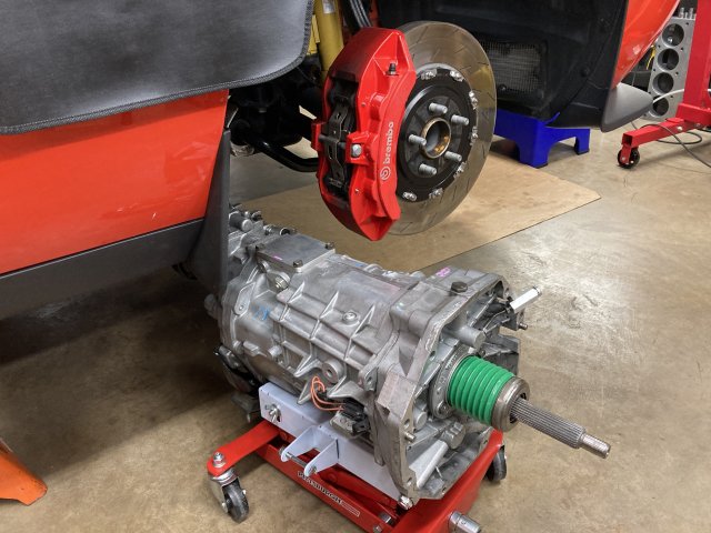

7F5E0852-0270-41B1-927E-E98747C7DE10.jpeg 6B559B71-2BCC-4718-B191-AD3F77054161.jpeg

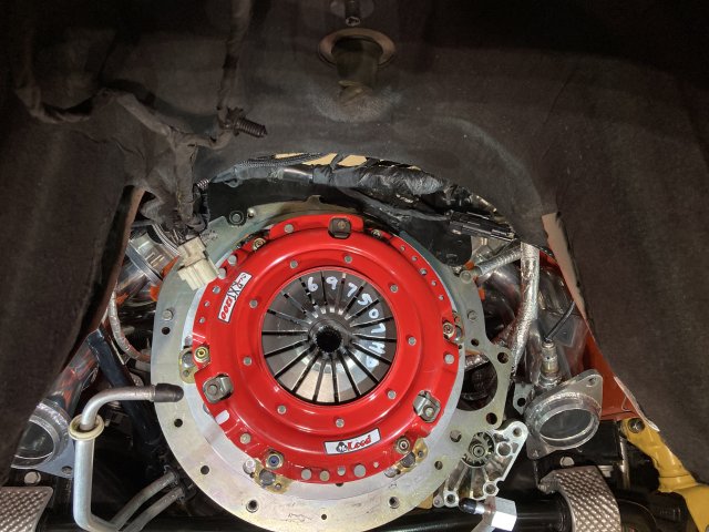

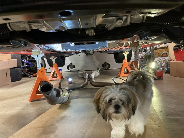

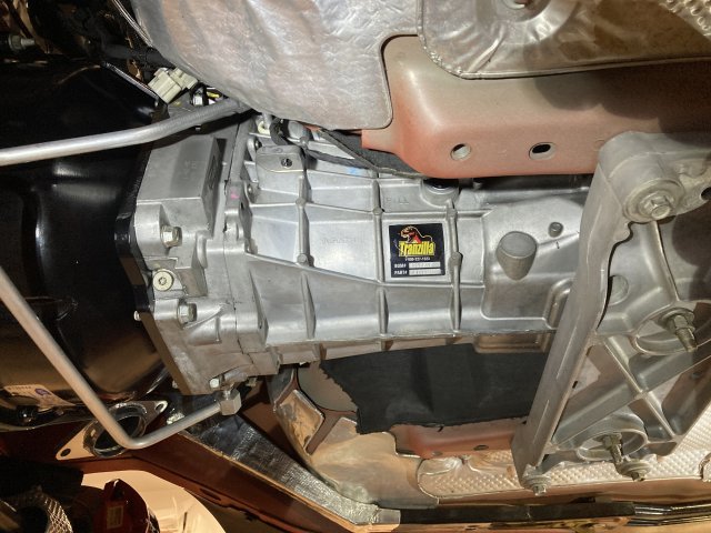

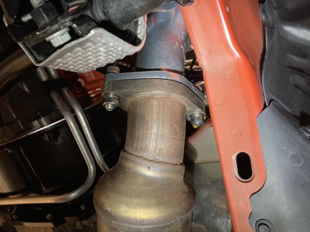

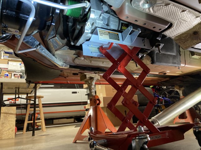

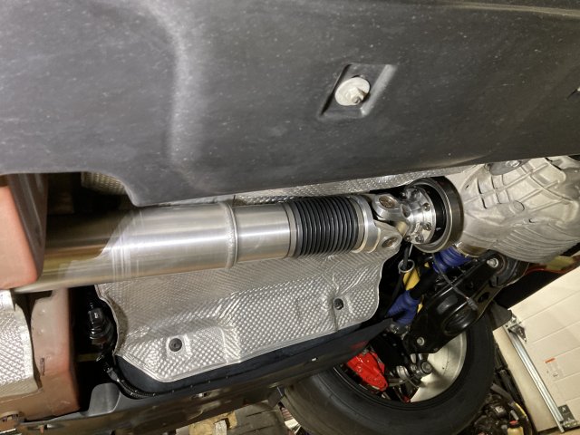

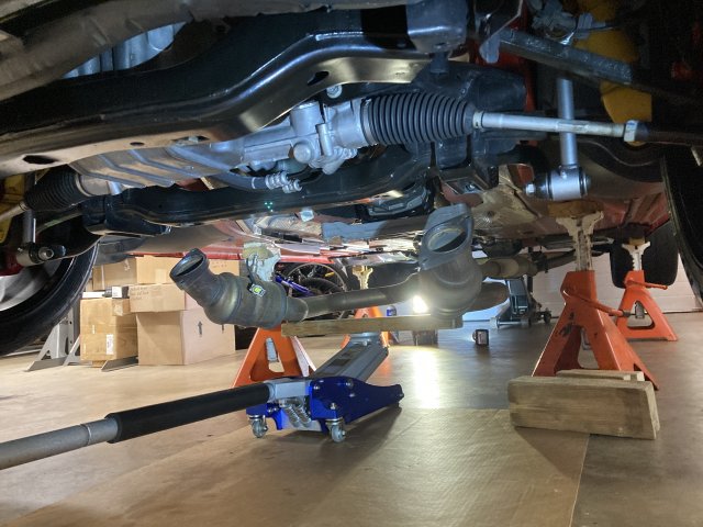

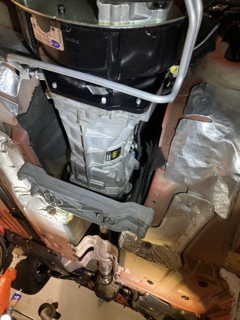

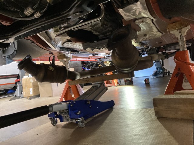

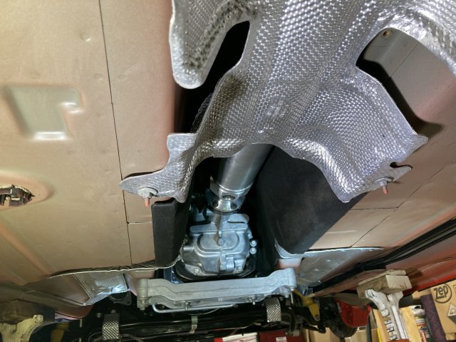

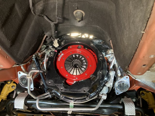

Transmission slip right in like it was buttered. Spins super free with clutch in, absolutely no drag, Clutch disengage/ engage point about 1/4 off the floor, fully engaged at half pedal, feels GREAT, happy with it. Here’s BDC6B8DC-AF22-4489-900F-D7E4165C6677.jpeg 5FB1C6BC-3C7B-4ED5-B068-75C941BB1AE7.jpeg FC39DC65-04E2-46C5-A882-288CBABC2BF2.jpeg B5B1C492-0820-4B8C-8EF9-0C66215DC868.jpeg 5D8E09EC-1E2E-48AF-92AA-DC43346633DF.jpeg A86AC6DB-E447-46B2-A959-167DC0822886.jpeg 4F8AF746-C681-4C8C-B726-9D8482FC277F.jpeg 565DE506-A52E-4FB6-871A-C1C6C38437EC.jpeg 448B3011-5842-4FA3-AD96-5C37D578FC3A.jpeg E634D798-D58E-4B44-A454-8EB3BB9694BA.jpeg 658888E4-4228-432F-B563-97CDB9179770.jpeg E099EF79-B897-4DED-82CF-AAB1D55957A0.jpeg 8AA29EF7-3F71-4906-A18A-72F3D654DD86.jpeg C1E67B19-7435-486D-A102-13E3ADF7B317.jpeg how to put the exhaust on by yourself.

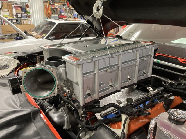

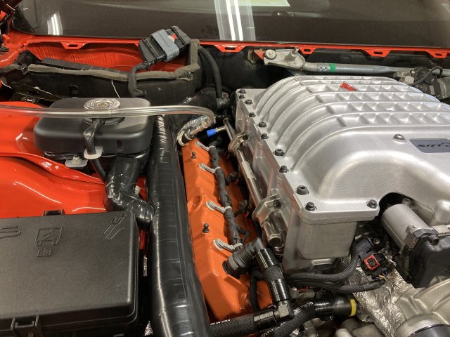

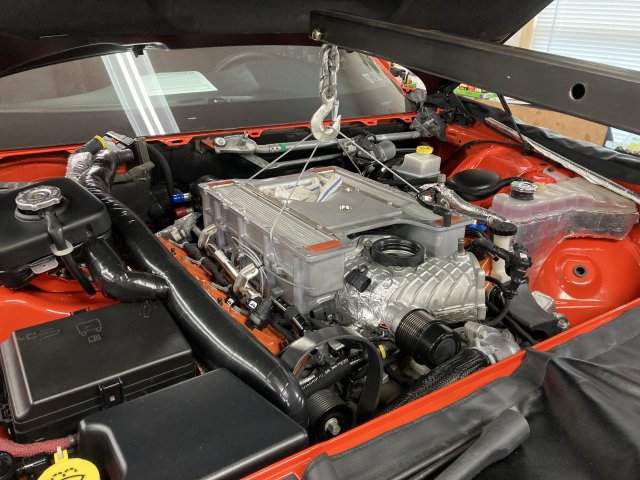

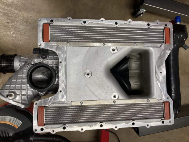

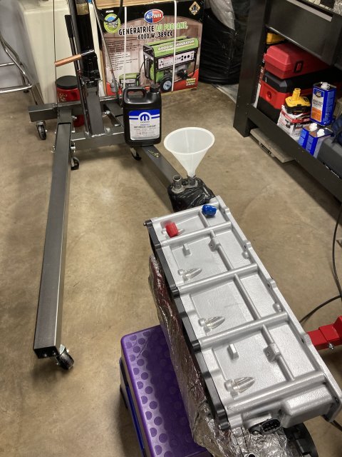

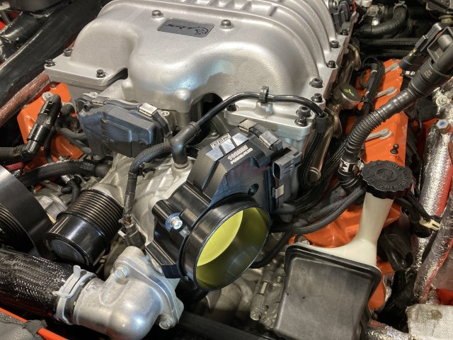

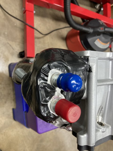

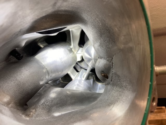

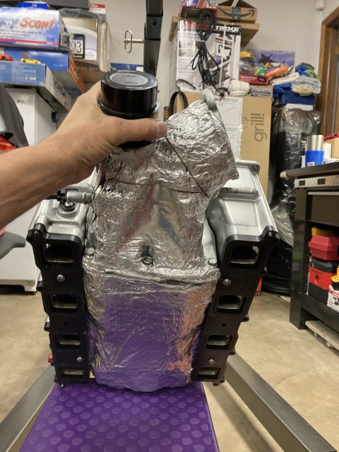

To avoid air pockets in the blower stand it up and fill it and cap it. Double insulating blanket, a look into the throat of the beast, easy way to put blower on by yourself. DA2C4A16-C771-4B9F-A1E5-D9CF05D5C471.jpeg 00EA9629-2725-4A52-B06B-49326A638504.jpeg E3052C10-A743-44B8-8022-363193DEE0EF.jpeg EF6AF092-862C-423E-9709-5D39CF9FF8B0.jpeg 32D60995-CF96-4D85-A55C-0BA6F3B335EC.jpeg BCD9C32F-A6F8-4A68-8E0E-CA27B8A1777B.jpeg 6452893C-ABE2-4107-BBC1-7D52A14DF70A.jpeg 9E1497F9-8730-4166-A466-1B687ADC2A0B.jpeg 050C3A58-BEC8-4537-BA1B-D19BD1A67E33.jpeg 98392636-3979-4E29-9BF3-B2CA832440CB.jpeg 4B808B50-6F7C-48DF-B292-D6630885BCA4.jpeg B0BD25A1-3597-4854-B764-42A67F2B39B3.jpeg CAAB90B4-08E1-4EBB-9DA2-75027FC3CF09.jpeg

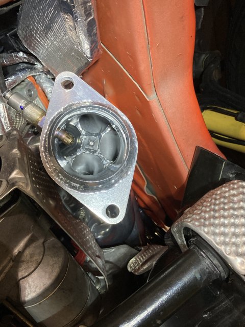

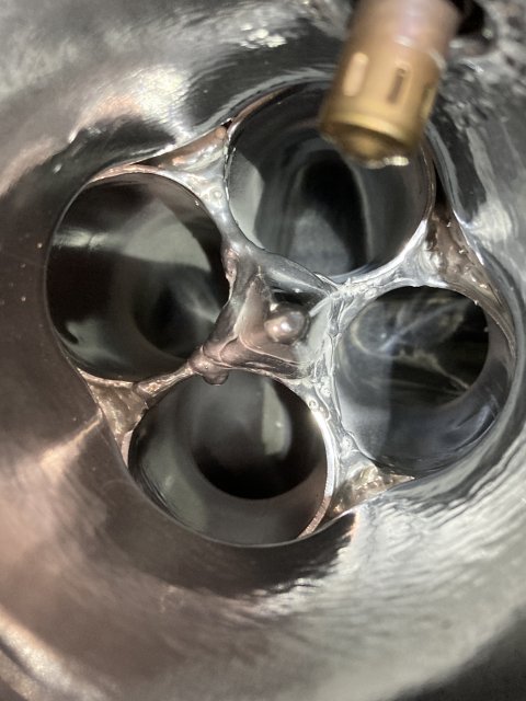

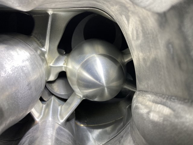

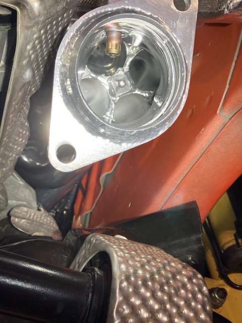

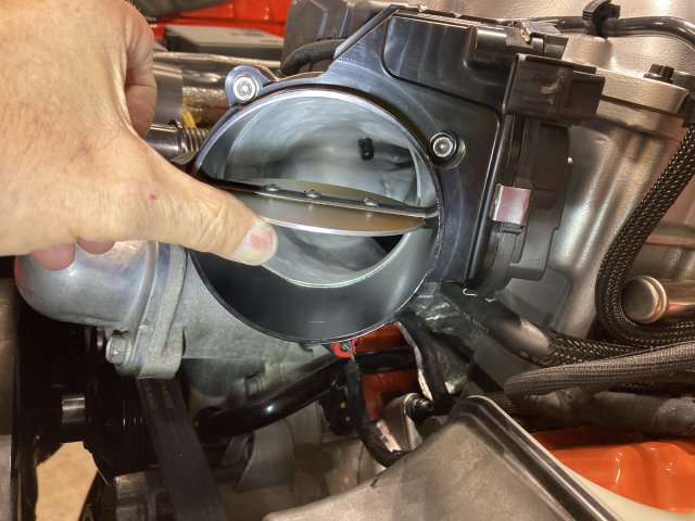

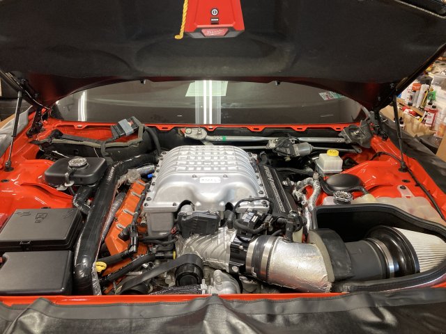

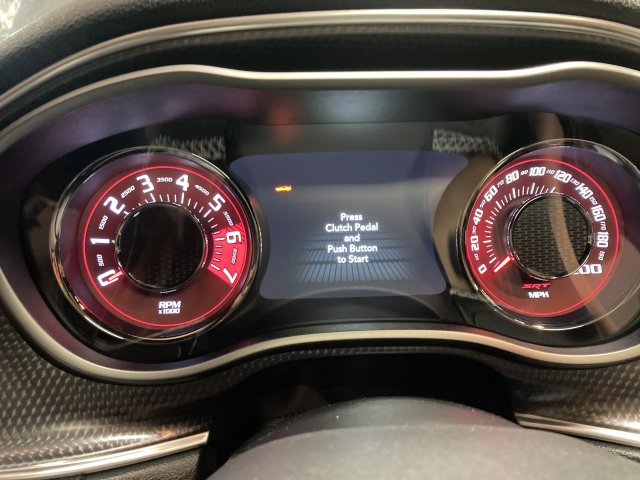

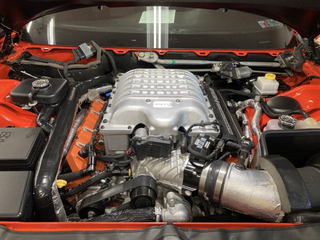

The 100mm BBK TB matches up well to the hogged out snout. Drain tank tomorrow, put 10 gallons of fresh 93 in, pray to the gods, push the clutch in and push the start button like I says 92CDF386-84B6-4479-9C44-9758B0565761.jpeg D0833019-5DEF-4848-8972-86116485B6FC.jpeg 2ECE4FBB-DDBA-4338-963D-3EA22A6D718F.jpeg AD23E0D8-1198-47CA-B3EB-519918C2FE5A.jpeg B933FD60-6DF3-41E4-A262-2372665F0892.jpeg F1803010-3072-4FBA-8BF9-7E3D517781C6.jpeg 49D108EE-A0ED-4D92-A036-32262F50E377.jpeg

Impressive work. Even more impressive when all done on jack stands. 👍🏻
NEVER again lol!!!
7,473
19,638

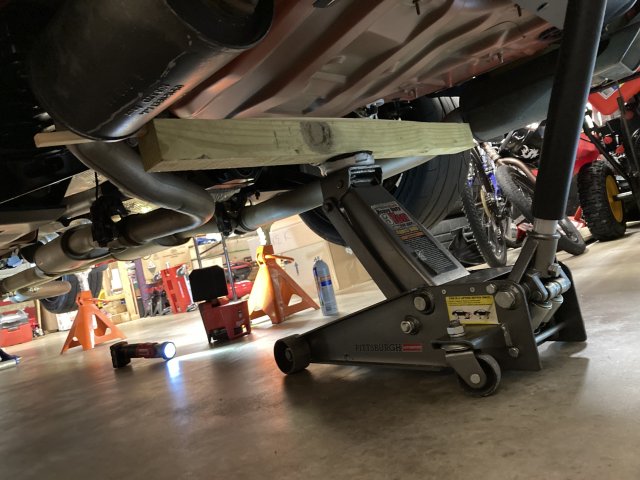

Dude, the wood jigs on the exhaust is genius. I'll definitely be stealing that idea. I had been dropping it on my chest on a creeper and straining to keep it from dragging the floor while rolling out LOL.
...and alone, I should have added.
Doing this alone off jack stands was a often thing in my youth, sometimes in a driveway or parking lot out in the element but I’m toooooooo old for this shit anymore lol, up down up down crawl in crawl out roll around a billion times, see how shiny the floor is?? It’s from my ass polishing it lol. THANK YOU for the kind words, it’s better then Motrin for the pain lol that someone has an idea what it took to accomplish this this meticulously in a sardine can off jack stands, my only savior was is my garage is air conditioned or I would have burned it by now lol. 👍
I'll be 69 in a month. I don't bounce to my feet off a concrete floor like I used to. So I feel your pain, as Monica's boyfriend was so fond of saying. ;)

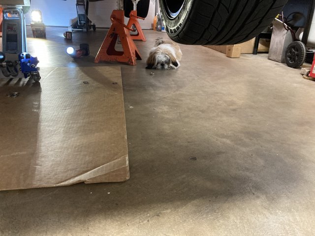

PS, I guess I wasn’t totally alone. I had my bolt steeler, bolt looser, rag stealer, never leave me alone little buddy with me almost every second, and I mean EVERY second lol. She really is the other one that came back to us, no doubt in my mind. 36488CB9-5059-4C00-A044-BBA5731C4E15.jpeg F66911C2-BF9C-434B-B47E-51B2F4A7EE14.jpeg 393433D9-6E38-4435-B52F-1CCEABBDFD31.jpeg 9184D2FC-A9FF-4F72-BE72-EF0347864566.jpeg 278D0F45-DF02-413F-BD7B-DE3842E68617.jpeg D622BE29-B24E-4A26-A2A9-FEA261201131.jpeg 72A025F8-6263-4B6F-AF6A-53105E18354D.jpeg Every second lol

I love dogs but I'm never petting that one lol
