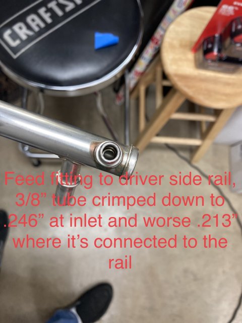

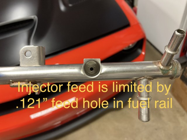

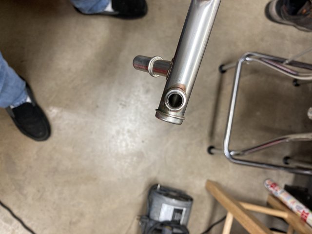

I think I stumbled on to why stock fuel rails don’t keep up especially once on corn. I switched to corn back in September, a Flex Fuel tune. I installed a dual 285 fuel pump set up on dual FPCM’s but stuck with my already tuned for on 93 ID1050X injectors. Tuner said it could be done on the 1050’s and it can be. But as I’ve inched up to about 925 wheel now on tested 85%E and now cold weather set in with DA in the -1000 to -1500 range I’ve notice my fuel rail pressure dropping from commanded 90 psi to 80 psi and pump commanded at 89% which is max and my injector Duty Cycle go from an OK 75% to 85-86% which is about the max safe limit to push them too. In discussion with Rick at tapped he told me change to fore rails and their feed line and I’ll gain back 10-15% Inj DC and fuel pressure back because the stock rails are limiting flow. So I decided to try this verse the expense of going to a bigger injector and also having to retune for such which on a flex tune is like starting from scratch again. I just happened to then score on a set of Fore Rails with feed line and factory sensor for a killer deal and was looking forward to trying out Ricks suggestion. Well unfortunately that deal fell through because the seller could not get the feed line uncoupled from the fuel line from the tank and ended up having to sell the car with the Fore rails as there was no way to get the coupler out of the stock fuel line without destroying it, BIG BUMMER!! So it was back to watching out for another Fore setup. Well today in the shop I was doing clean up and organizing and had a set of stock rails for my spare blower sitting out and I wanted to seal them up and box them for storage. Well during this process I decided to look them over for what makes them restrictive, and I found it!!! And how stupid it is!! So we equip the car with 1/2” fuel lines but at the main rail feed connection fitting the tube is rolled over snd necked down to .303” of an inch!! Worse yet further down the tube where it’s connected to the rail the hole into the rail for ALL the fuel to go through is .277” of a inch!! WTF where they thinking?? And it gets worse!! So the main line feeds into the Passenger Side rail which then feeds the Drivers Side rail through a 3/8 tube fitting, they couldn’t stay 1/2”?? Ok, 3/8, not too bad BUT this fitting is rolled over on its end as well and has a inlet diameter of only .246” of an inch, smaller then 1/4”!! And believe it or not it gets worse!! That tube where it’s welded to the tube it’s supplied from the supply hole is only .213” in diameter!! Holy F$#k no wonder the system can’t keep up!! And now yet there’s even one more restriction!! The bung where each injector is fed from? Well each is restricted to feed through a 121” diameter hole!!! OK, I can relate to a bit of why this is, to help keep a more even feed pressure in the entire rail and regulate a flow to each injector but dam who would ever think to look in there and see this! Just think if you where trying to feed 1700’s through this little hole, definitely a pressure drop would be in that area between injector inlet and fuel rail!!
729FE002-7F3E-4D74-8CA4-88D68959AC6B.jpeg 17B513DA-A486-45E3-ABF5-F762F61E5C93.jpeg 70B8980A-C464-4B47-8912-B2EF9BC0E1AC.jpeg A0BD374C-2613-44B9-940B-21CAAE545184.jpeg FDB4AE86-BA00-417A-8BA9-30C760D2F9AD.jpeg 23BC3E9A-157F-41F7-81A3-2017E756FD4E.jpeg
So....., I’m going to “port” these restrictions out and make these fitting be the max inside diameter of each tube which for the 1/2” tube is appx .420” and the 3/8” tube appx .310”, a BIG difference!! And see if I gain fuel pressure back and some injector Duty Cycle back!! But unfortunately I don’t know if I’ll get to test them in the near future as it’s now snow and salt season here in Pa :( So.... I’m looking for a volunteer that is in about the same boat as me, dual 285 pumps and 1000-1050 size injectors running E85 and getting to just about max Inj DC and seeing fuel pressure drop below commanded at the rails. @Speedy! I I think you may be close in fuel and injector DC as well in cool weather?You want to try a set of “Ported” stock fuel rails and see what it nets? If yes I’ll ship them out to you once completed. The mod won’t weaken or compromise them at all, their welded on the outside not any where near where material will be removed. The orfice in each injector port will be opened up to the same size as Fore Rails are. They should only take maybe 1/2-1 hour to change out. If no volunteers I may postpone pulling my blower and trans as planned for some upgrades and cross my fingers for a warm day (35-40F will do)in early January in Pa and being the Mexico boarder is only 1/2 mile from my house and I only need a 2-3-4 to 6500 rpm 12 second pull with data log to find out apples to apples get my just detailed for winter storage cat dirty to find out, I gots ta know!! Any one game to try a set of ported rails and see what it nets? Just think, this could save big bucks by not having to layout $650 for Fore rails and feed lines and more so the in ability to use the fancy valve cover covers which in switching to the Fore rails won’t fit any more. This could be a EUREKA finding here, need a tester!! Anyone game??

The stock fuel rail is a whooping .650” ID, the Fore Rail is 1/2”, around .500”. So there’s no reason stock rails can’t keep up once the restrictions are removed. I’m going to mod these in the next few days, but unfortunately this upcoming snow storm is really going to put a dent in getting out to test them under extended WOT top of 4th gear 1/4 run in same conditions as previous runs.
Here’s looking down the barrel of a Fore Rail, stock rail ID calculated from OD minus .050” wall thickness of tube used to make them.
Here’s what’s coming

18F1BFC6-A500-4517-9AA7-851B8C40885B.jpeg 37621976-EE57-4FB0-AB68-DE9B76A27636.jpeg
The only concern I'd have is cleaning out the rails after drilling them. Flushing them perfectly may not be super straight forward and any debris at all into an injector can have bad results, obviously.

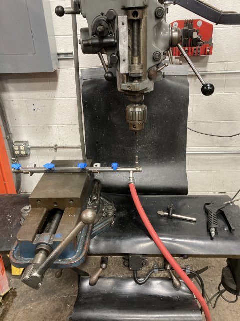

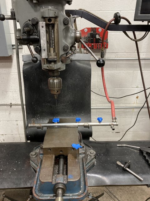

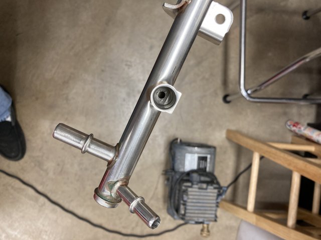

Already had a plan for this. I Drilled one out today, I pressurized the rail with clean and dry compressed so all the chips flew out as they where generated. I drilled them out about .015” at a time, I still need to debur the holes in the injector bungs which I have a plan on how to debur both sides of the holes already as well but I’m elated how they came out. The inlet feed looks the part now for a 1/2” line!!

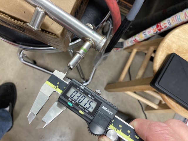

Primary inlet went from a .277” restriction at the inlet of the rail to a whopping .413”!! the feed port out of that rail that feeds the drivers side rail went from .213” to .302”!!. I drilled the injector bungs out from .113” to .204”, I stopped when I started getting close to the spot welds that hold them to the rail but they are brazed in place as well and no compromise in strength what so ever. The hole is now almost twice the diameter at .204” and will be plenty as it now almost matches what the feed port to the entire drivers side rail was originally!! I wish they were both done today as I would have gone out tonight and tested them before the snow storm starts tomorrow of which now projections are 18-24” in my area, yuk yuk yuk yuk YUK!!!!
Tomorrow drill and debur, and blow out from a bunch of different ways, fluid flush into a fine screen so I can see how if even one chip was left in the tubes them get them in the car and waiting for this crap to melt for testing.
