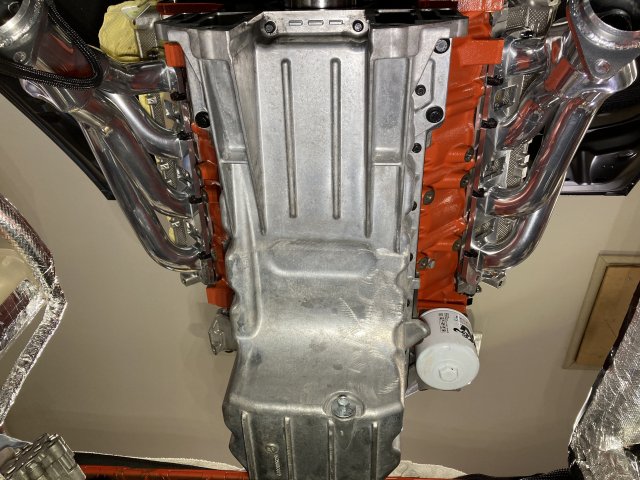

Lots of progress! I'm very surprised on the bolts hitting the pan. How much clearance did it take?
About 1/8” right at the top of the pan rail right in front of where the 2 rear bolts are. I would’ve taken a picture but my phone was dead and I was dirty tired pissed off hungry and just wanted to get it back on LOL

Am I the only one NOT impressed with our cast-aluminum oil pan??
Does anybody have any experience in reworking/finishing/polishing cast-aluminum into something that doesn't look like "poo"?
:unsure:
Why, whom needs to look at it? Are you trying to impress the protesters you want to run over:unsure:

Actually I like it. My last cars had stamped steel pans. This is a huge upgrade but until you take the belly pan off you can't enjoy it

BTW, I had a 6.1 stroker motor built probably 10 years ago by BES Racing. Beautiful engine and I had a beautiful aluminum sheet metal pan made for me by MOROSO. Metal art work it was. Anyway, BES put ARP studs in the bottom end for me and when I got the engine back and onto my stand, I tried to fit the custom pan on it. Moroso uses a real beefy CNC machined pan rail and it wouldn't clear the studs at the back. I forget exactly what part of the studs, likely the nut and washer. I ended up clearancing the thing with two nice, half round notches in the rail and all was well. Really thought it was just a problem with the rails used in the Moroso pan. Really surprised to hear a stock pan won't clear either. Good to know for future builds, if I ever do one again.
:unsure:
My special car has a special pan with a really cool SRT Hellcat logo cast into it. Because I'm special. Eat your heart out. :ROFLMAO:

The oil pan the Redeye engine I put in is polished and has a Hellcat logo embossed in it. I was surprised to see that.

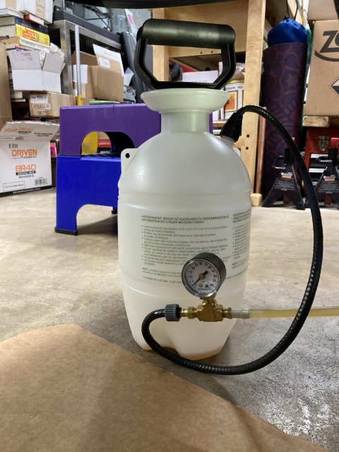

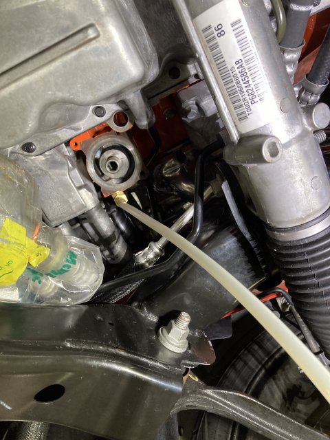

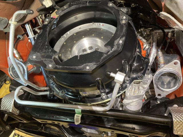

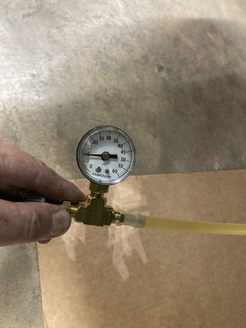

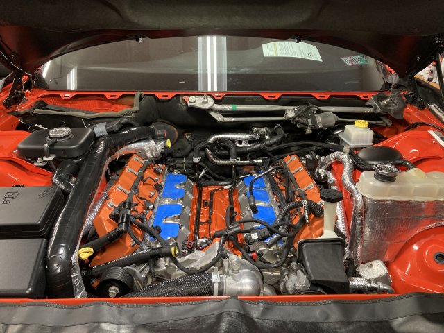

Engines ready for blower, dial the bell in then be ready for trans, maybe make start up for my B day!! Pumped 2 qts of oil in it through the filter until it poured out the top, rotated it over about 2 revolutions while it had 10 psi of oil pressure.

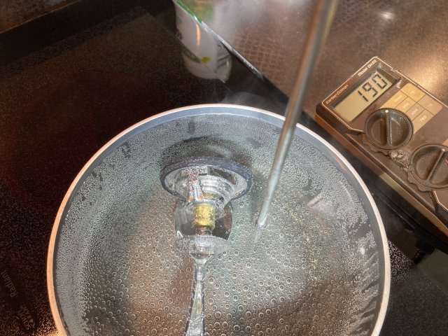

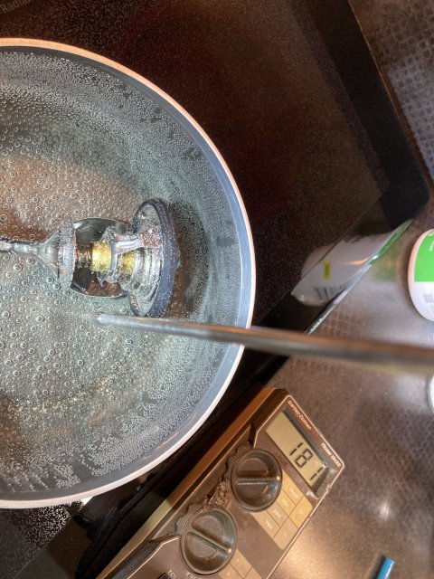

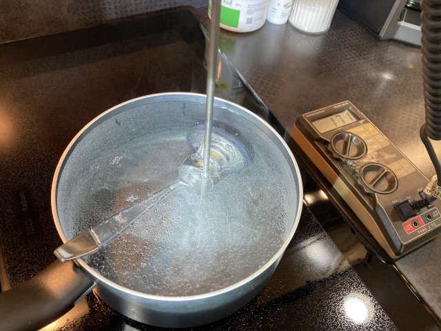

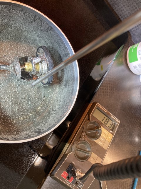

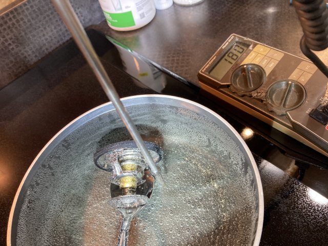

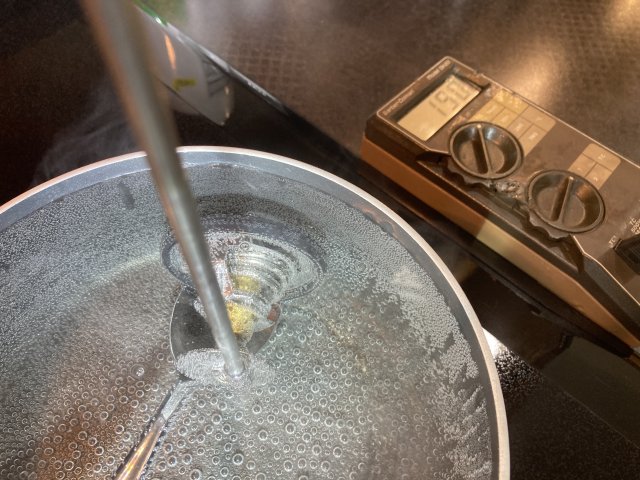

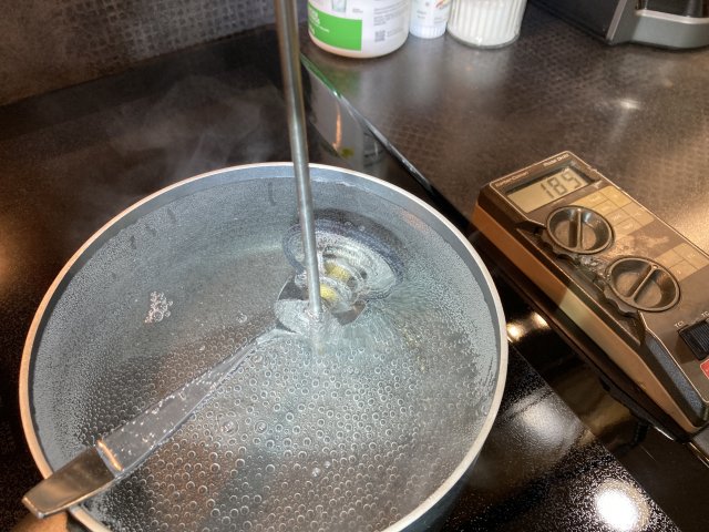

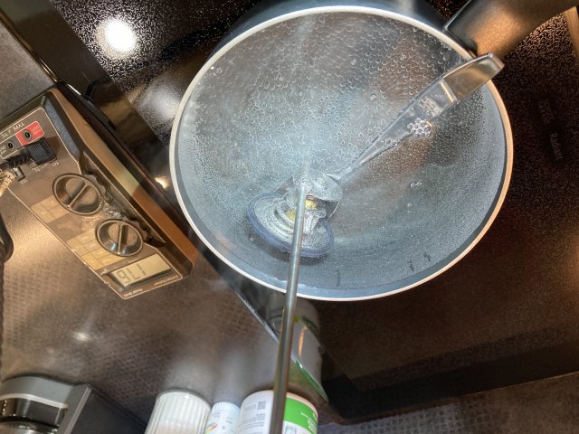

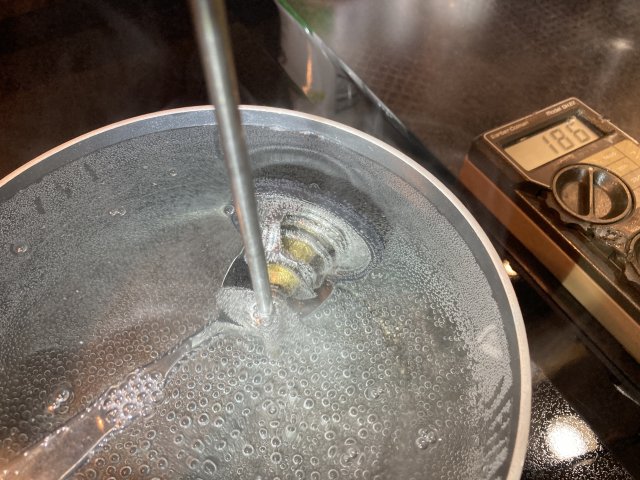

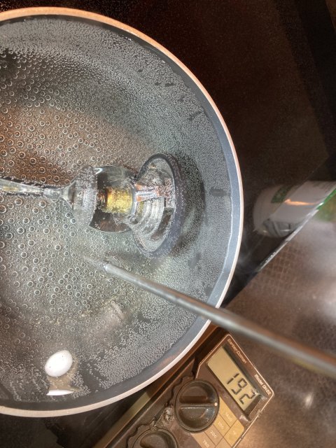

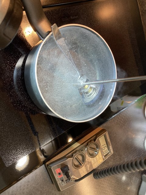

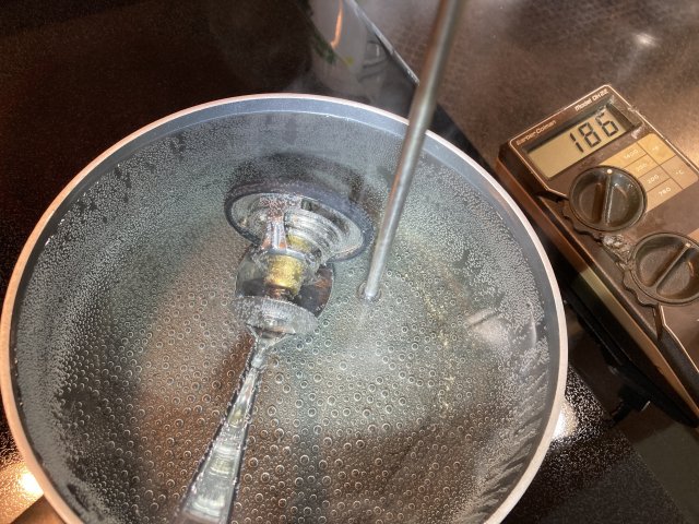

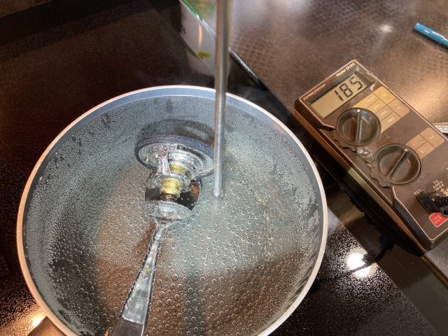

The Misimoto T stat started opening at 180 3E5B333E-6791-483D-BB9F-1768B9812B29.jpeg A8BE79D8-A855-464B-96D5-9A6E40743416.jpeg 1CB77D21-2492-423B-8859-006935342E78.jpeg 79483E5E-B70B-40C4-B6CE-81B16C27E590.jpeg 7F56A676-5191-4C43-901C-05C57DA1E732.jpeg 3C3A7FFB-6038-4945-9450-95A464590160.jpeg CC472590-34DF-45FF-80D7-68ADFDA37726.jpeg D076B4A2-8130-4ECB-B7B1-7A1CDF4E2D3D.jpeg 896BA4B8-F679-4A4F-AB11-F96BB33EC412.jpeg F37C12B7-D204-4111-BF0C-63DE51A66454.jpeg E51989F2-1DD7-4F7E-A2D7-1B263DDA9712.jpeg B0DADF1C-CEDD-4626-A662-6C650F438E9C.jpeg 57157A5E-3145-4E4C-9915-C0F9374CD069.jpeg 56695F65-BAA4-47D0-B9D6-9DB58C30E6FC.jpeg and by 190 fully opened, on the cool down side was fully closed at 179, pretty impressive, used it.

That's why I spent $50 on the Mishimoto instead of $18 on any brand X. They're accurate, reliable, and well made.
