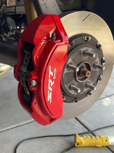

Guess who @BULL helped yesterday? I have already posted early in this thread about the advantages and how I use them 100% on my Challenger on the street. We did my Durango after I unfortunately drove 7500 miles on the Brembos. They worked great, no complaints. Except they dust in a horrible way. The dust is really annoying, ugly and necessary to clean regularly and is a PIA. For me anyway I took the Durango and just drove it away. Since I don’t bother to “bed” my Challenger after I remove the Hawks after race days, I told Bull screw it, they will work fine. Drive about 70 miles doing different things yesterday. If I did not know, I did not notice any difference stopping that Durango on the street. Oh, except a couple times coming to a dead stop, they don't bite and grab like the Brembo set. I can make a professional limo stop with a damn diamond cutter in the back seat. More smooth than the Challenger drives and that is smooth! Also, these calipers will stay clean like this now.

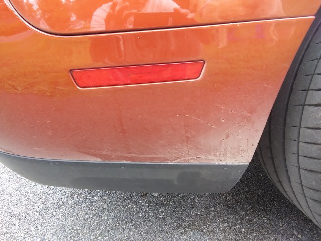

For the record, the OEM pads did well stopping from 191. The turnoff is about 3/4mi from the 1.5 line. Worked fine, no smoke or smell, or blue rotors. :)
As much as I hate the dust, I am comfortable with them doing what they need to do. Photo shows the dust on the rear. The dust from the fronts is distributed over the entire side of the car. I guess they are charged particles looking for purchase.
