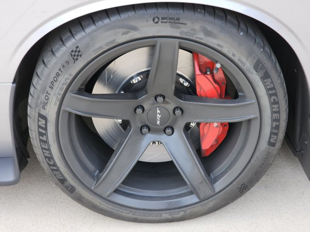

On my 2021 Scat Pack, I changed mine out to Z26's at twelve miles. These are the 6-piston versions. I've had SRT's before and decided a long time ago I couldn't live with the rotor wear and the dust. For street use, I'll never go back to stock pads.

Note, these would be the newer and slightly larger pads paired to the 400mm diameter rotors that those of us with 2019 and older models can use.
