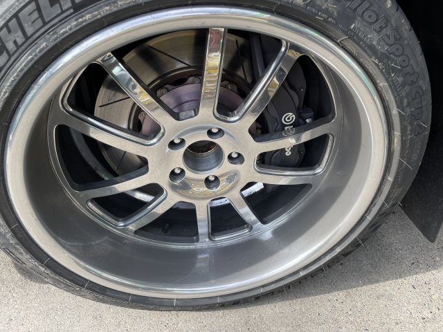

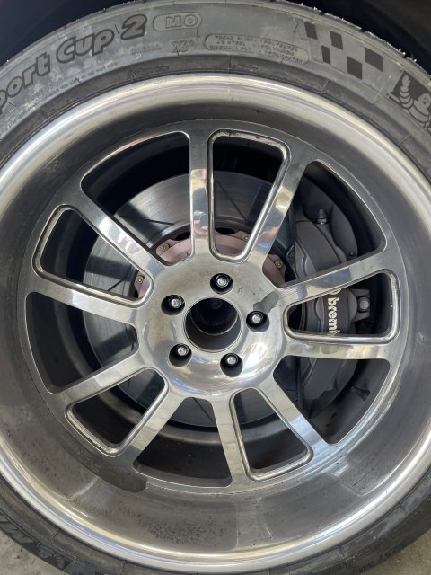

Go bed in the Hawks and the wheels come back looking like this! Yep the DP rotors have checks. They all do it and hope they are my last set. Hint, hint! Dust galore!

These set of pads are working really well on the DP rotors. Nice blue coating on the rotor, exercised them extensively last session. Yes, that is a pile of brake dust at the bottom of the wheel.:cool:
