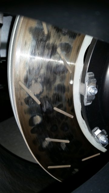

All four (I seriously do NOT recommend mixing pads, especially like I do.) Do as I say, not as I do. Really...
Z26s are good for aggressive street driving and if bedding correctly/well can have really good initial bite and stopping power.
That said, their initial bite is not quite as good the O.E. pads, they will fade if used on a race course and will severely heat check your rotors if you do.
Bedding is key to making the Z26s work well, if you don't, they will be subpar.
