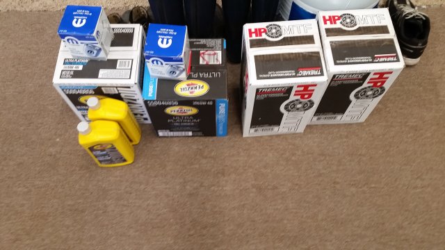

No CDV yank or skip shift bypass for me yet but I do recommend changing out the factory fluid with the TREMEC HP MTF. 20200314_100828.jpg 20200314_110719.jpg

No CDV yank or skip shift bypass for me yet but I do recommend changing out the factory fluid with the TREMEC HP MTF. View attachment 61658 View attachment 61659

The TREMEC fluid is definitely noticeable in "feel". More buttery shifts I guess you could say. Didn't notice any noise delta but mine was very quiet before.

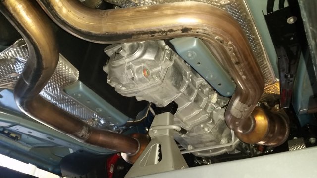

Yeah it’s definitely the throw out bearing I’m hearing. I may just be hyper sensitive to it though and I only hear it at slow speeds when engaging/disengaging in the 1-2 shift.
It doesn’t sound bad, I can just hear it, maybe I’ll just make a piece of insulate to mount below the shifter boot when I install the Barton.

It makes the most noise when I’m at a stop with the car in neutral and my foot off the clutch pedal. The minute I engage the clutch, the sound goes away, that’s why I’m assuming it’s a throw out bearing.

Well after popping the trunk and looking at the stock parts the seller sent with the car (which I thought was just the intake), the stock shifter is in there.
He said he had installed a Hurst shift knob, turns out he installed a complete Hurst shifter assembly.
@mopar madness hooked me up with a Barton, so I’m going to install that and see if somehow the Hurst shifter is causing more noise/vibration than it should be.

Thanks for that info. I’m swapping it for the Barton anyways, so we’ll see. I’m 99% sure it’s the bearing though, which I’m hoping Dodge will cover under warranty.
If not, no big deal. I’ll live with it for a bit (not my daily driver) and pull the transmission when it gets warm haha.
