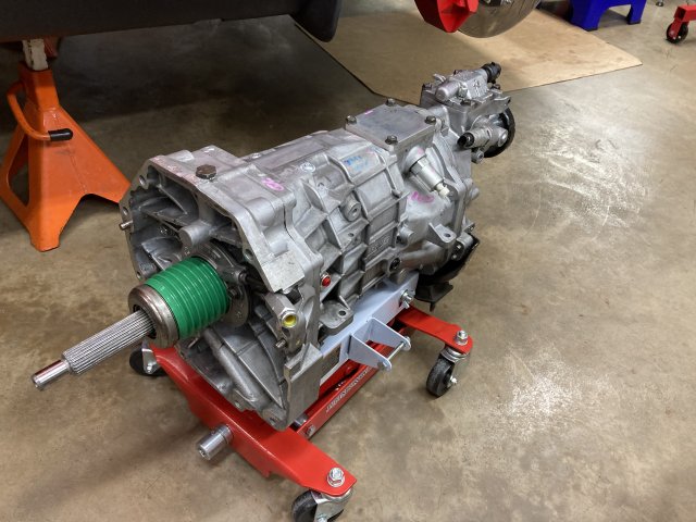

TOB assembly is the green unit on front of trans. The cylinder is under the green bellows, the bearing itself is the silver color disk on the end. They get dry quick but can be relubed with a needle attachment to a grease gun. I inject them with a sticky viscus grease and never hear them again. The broken input assembly is what is turning when the clutch is out, both pieces. When ice cold the fluid is thick and the opposing gears get chattered by the thick oil trying to turn them.

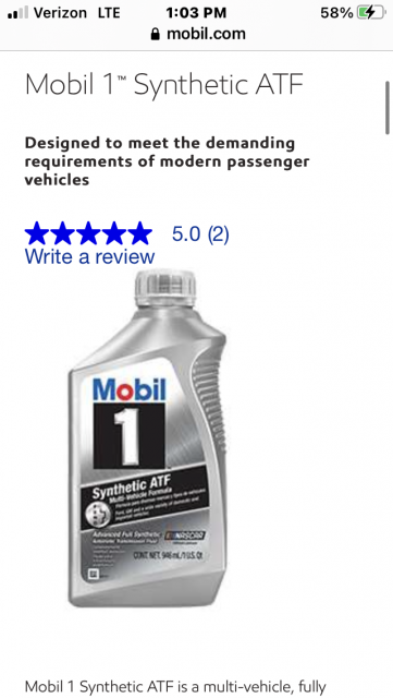

Try this fluid, get 5 quarts, over fill the trans a bit so oil is coming out as your tryin to get the plug back in, it helps with slosh on launch when all the oil is thrown to the back of the trans enough stays up front to keep second and third happy, stock oil sprayer only hits first gear.

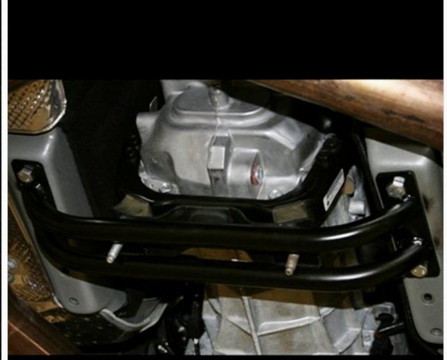

Prepare yourself for the tranny to piss fluid all over the crossmember. Good times! You might want to check your options as far as supporting the trans and dropping the crossmember, but I couldn’t be bothered. I believe Pettys Garage offers a trans mount but it’s for A8’s only. Love to see one that would allow us to drain directly to a pan.

It does make a mess, one you can’t clean up easily either as it stays in the nocks and cranny’s of the mount. Put a jack stand under the trans and drop the mount, 6 bolts, 2 minutes with a impact.

The Petty part looks like it would make dropping the tranny fluid far less messy.
