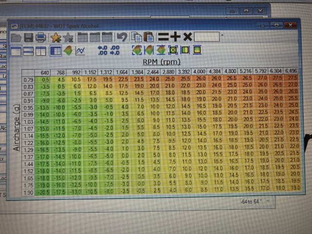

Keep in mind there's a limit to how much power an engine will make with added timing. You get to a point where you add timing and the engine doesn't make anymore, so really it's about finding the right fuel for your setup. Those running 20+ psi and 21 degrees of timing probably need something like E98. Those running less boost need less octane. Dialing that in is where a dyno is actually useful.
The most common "900whp" packages are tuned with 20-21 degrees on pump E.

When referencing max timing, you should also quantify it with the aircharge associated. For example 1600 aircharge and 21 deg is one thing, 1900 aircharge and 21 deg is entirely different.
Looking at the Demon factory calibration, it has an MBT at 1.75g of aircharge of 26° in the standard MBT table and 28.5 in the HO table so an additional 2.5° at max aircharge and RPM. Down in the 2880 to 4800 RPM and 1.75g aircharge it's 4 deg more on HO at 28.5 to 29.

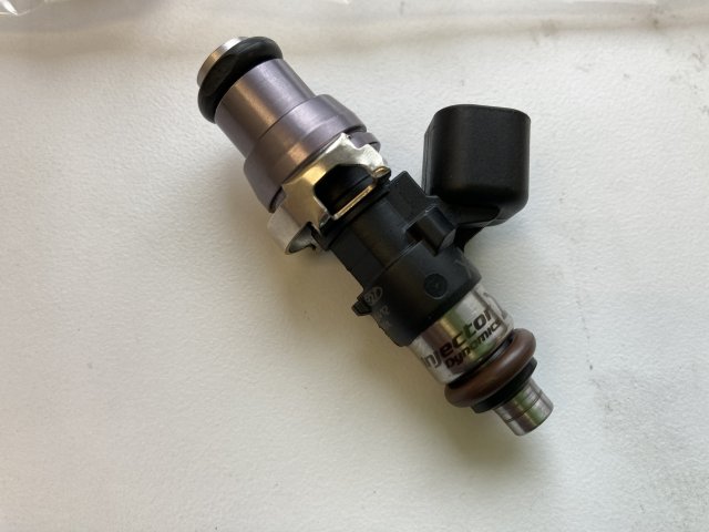

My dyno charts of 10/20 where using this WOT timing map with sensing E77 I only got to 18.5 degrees in actuality.
Im hoping to get up to 21 degrees in the final timing table and with E85 and full timing end up around 950-975 wheel and torque up around 900 and I’ll call it quits and keep my fingers crossed it stays together. I’d be elated to crack 1000 but don’t want to crack anything else in the process lol. Next dyno visit is 11/5, we shall see!! 🤞 4C65A6A4-4C4A-46AB-83AD-4C5D2443432E.jpeg

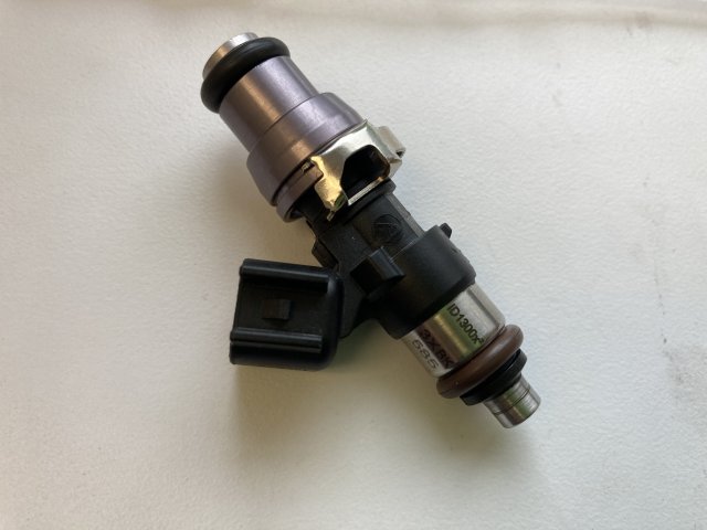

As in ID 1300's??
3,319
7,832
Thread Starter #99
ID1300X2 where designed with flex in mind and idle and part throttle stability when on gasoline. It’s what I originally planned to use and had a set but sold them when I found a tuner that said by 1050X’s where plenty for E85 and 17 psi of boost I sold the 1300X2’s to fund the tune.

As in ID 1300's??
Yep. Those.
The ID injector data and their consistency is a big reason why they're popular. It makes that part of the process so much easier and in the hands of a gifted tuner the idle/part throttle is as good as you can ask for.
