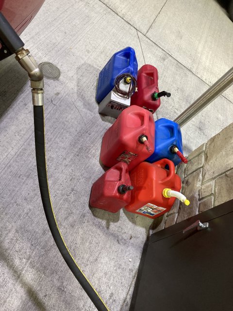

It's funny . I poured my X98 into a different jug that's easier to pour in my car and the X98 is crystal clear. The X85 has a yellow tinge to it . Must be the 15% gasoline in it . I'm going to drive till the gas light comes on then I will put 5 gallons of X98 and 5 gallons of X85 in then drive it the last 30 mins to the track to get it blended and the car adjusted. I will post pics later .

I went to the high station just before and stocked up on 83% E before this last station starts changing over to winter blend as well. Going back with 4 more new jugs over the weekend too lol. I need enough good stuff to last until at least mid November.

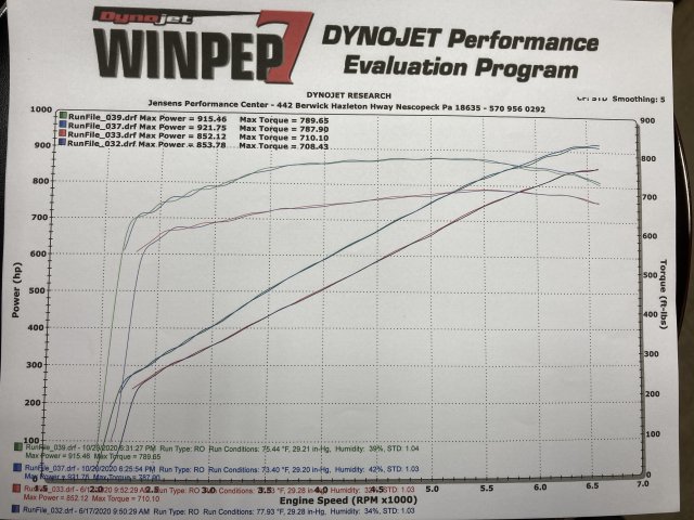

1Qt of Octanium per 15-16 gallons is fine especially if you trust your 93 your getting and are only making 16 psi of max boost. I make 17.8-18 at times on a 2.85 and that mix runs with no knock ever and makes 855 wheel on a dyno jet.
Here’s a dyno chart with 93 and 14 degrees of timing and E78 with 19 degrees of timing and a tame timing ramp.
It looks like the graphs don't match the numbers on the sheet there? Kinda odd if I'm seeing it right. Stops at 760 and 840?
