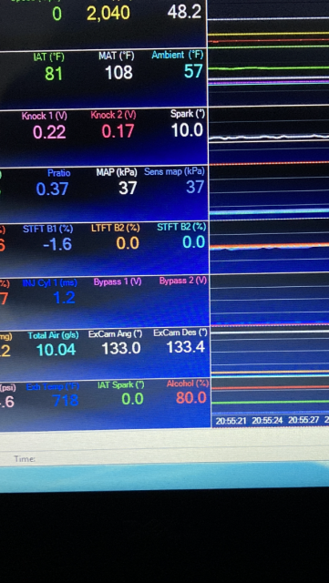

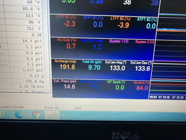

Car seems to be calculating E% better. Been mixing in 99% E and it’s reacted pretty appropriately with each addition.
Was at 77% added 5 gal of 99 to 13 gallons and went to 80%. Added 5 gallons again last night which took it right up into the filler neck and now reading 84%. Garage party tonight at my buddies Dyno shop, pretty much the same timing map as prior run, I’d be happy if she made 925 HP again and 800 tq this time with more E. Hell, I’ll be happy to just drive her home afterwards!! 🤞

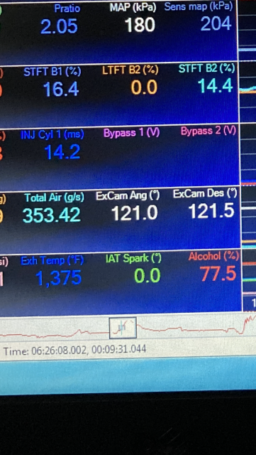

Quick question to those running flex fuel. When running ethanol fuel are your fuel trims positive? On mine with the flex fuel tune installed when I run 93 my fuel trims are within +/- like 3-5% give or take. As ethanol is added the fuel trims start to go positive and the alcohol content in the log rises. On full E85 the trims are like +25(ish)%. Ya'lls work the same?
I'm assuming that's how the car knows how much ethanol is in the fuel, as the trims go positive it increases fueling through the alcohol multi tables the proper amount, but the trims remain positive since there isn't a separate injector scale table for ethanol.

Where at in your rpm/aircharge range?
Idle and cruise mine settles around +/_ 3% but WOT it will go up to 20-30% . Positive . I ran out of time to fine tune it .
7,635
19,994
I hadn't reloaded a gasoline only tune in many weeks and my logs cruising around showed +10ish % STFT and +6%ish LTFT. WOT was almost +30% STFT and 0% LTFT.
Must be working as expected. I thought maybe my trims were off.

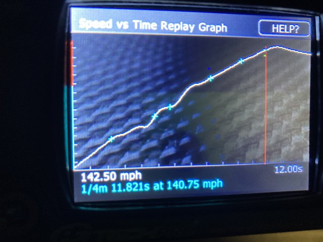

Look at the graph, was spinning in every gear including 4th at the1/8th mile lol. Every dip is a shift and spinning. I just put new Nitto 315 555 R2’s on the day prior. They hooked better then my bald NT05R’s finally
