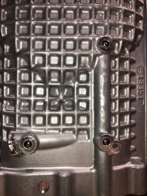

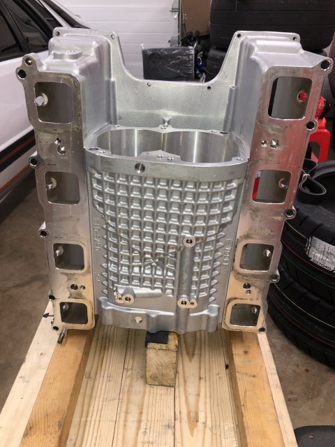

With the second picture being so close, I'm having a hard time seeing exactly where this hole is relative to a thermo blanket install. I ask because both my cars have the spacers and the thermo blanket installed.
Down on bottom of picture

^^Never noticed the 2 filtered air bleeds next to the bottom 2 check balls, I am going to pull and check I have enough clearance around heat reflective barrier to make sure they can breathe.
Now you guys are going to make me lift my SC's. Dammit....The cars are running so good.
