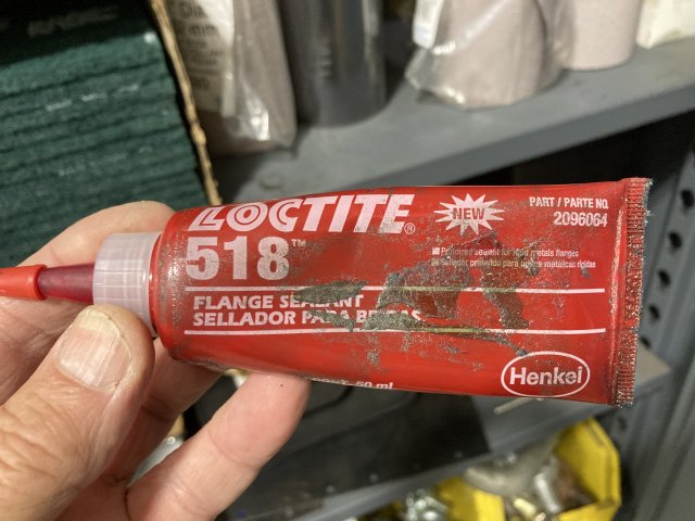

The anaerobic sealer that I use is this Loctite stuff works great doesn’t Hardin until made it and you wipe off the excess that squeezes out and it makes it perfect seal.

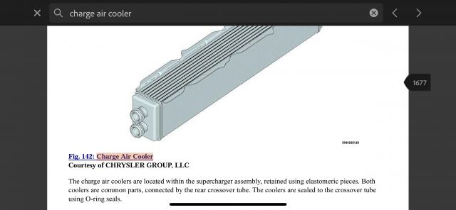

@fumanchu182 these are the little screws I'm talking about. Ironically when searching pictures I found this one that you actually posted a while back.
This was a really good rebuilding video. Guy wasn't aware of torque specs, but does mention tightening center screws first and then front and back last. If you fast forward to about 17 mins is where he's reinstalling the bricks.
Definitely was a great video to watch and I remember he does give torque specs and tightening sequences where available.

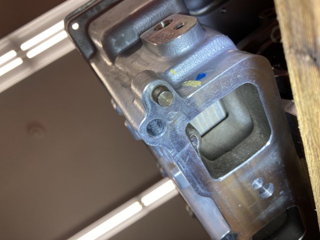

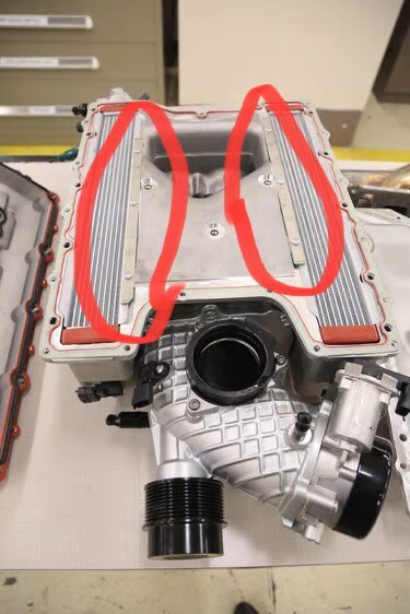

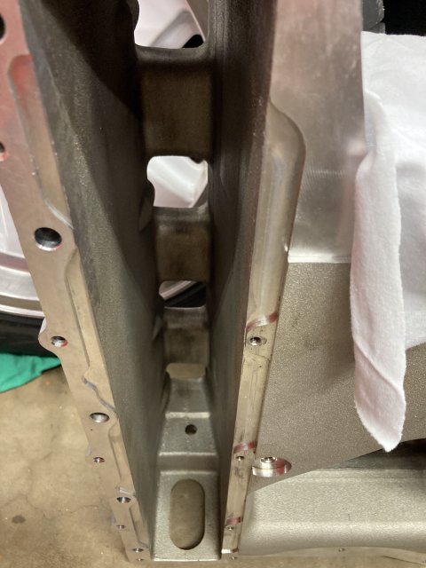

Saw about 1/2 dozen things I’d do different in that video. One thing I did notice in that video though right in the beginning notice in the supercharger under the bricks the individual runners that came up from the valve area to the bottom of the bricks. Thats one way one could tell a newer supercharger from an older supercharger. That’s one of the things they did to stiffen the case and also make individual port runners like a tunnel Ram intake. you can see the difference in the pictures here of an old blower empty case that’s wide open above the valve ports and in a newer case look up inside you can see how the runner extends all the way up to the bottom of the cooling bricks?
Newer supercharger, about 2018 and up, notice the runner that goes up to just under the cooling bricks
Older supercharger, 15 to appx 18, notice how the whole area is open and no connection between the supercharger chamber and outer walls where unit is bolted to the heads. This type is weaker and likes to break apart easier when twisted on hard with increased rpm and boost.
