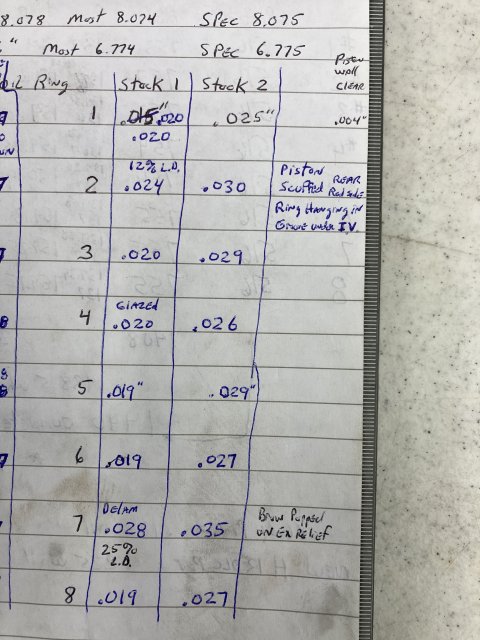

The problem isn’t the top ring, it’s the 2nd ring. It’s been suggested that the 2nd ring gap is too tight, and the pressures exerted on it are forced up to the bottom of the top ring which is the wrong direction, because there is next to no material above the top ring.
When you build the race motor I think you open the 2nd ring even more than the first to help prevent that.
Agree, my second ring gaps where .024-.029, plenty larger then the top to not trap pressure and induce top ring flutter which pressure between them can create. The top ring gets all the heat, especially how close they are to the top of the piston. Add to this stock piston to wall clearance was only .001” but pistons looked like the day they came out of the box, literally. The skirt coatings looked absolutely brand new snd untouched. Pin bores tight as hell, in fact until the piston gets to about 200F the pin doesn’t float in the piston. I’ve never seen such a tight engine build. Main bearing clearance was .0008-.0009” and rods .0010 to .0012”!! I measured this engine over and over and over with 3 different ever increasing accurate measuring devices and all it told me was it was even a hair tighter then previous measurements. New engineering engine clearance philosophy is tighter with a good thin oil created a better and larger around the circumference hydrodynamic oil layer then looser and thicker oils of old school thought. And this engine autopsy proves it works!! The bearings all looked an measured new. Except for top ring gap needing to be opened up about .005-.008” this engine probably would have taken 1000-1050 wheel all day long and stayed together for a long time. If me new rods and high dollar DLC coated pins where not of .927” size I would contemplate reusing stock pistons and bearings in the rebuild!!!

I removed and measured every one LOL. Tops where .018 to .020 except for 2 and 8 which where bigger at .022 and .024 and 7 huge at .032”. I think they got this way from butting and wearing hard on their OD’s pushing hard against the bores while in a butted state, 7 because it had so much ring directly exposed to the combustion chamber with the brow piece gone. Amazing the cylinder bores showed no signs of wear both visually and with a .0001 graduated bore gauge.

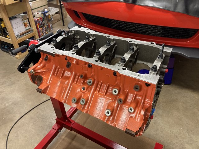

Interesting to note as it drove me bonkers with main bearing clearance as I was getting main bearing clearance at .0002-.0003” was until I but those tiny 8mm side bolts in and torqued them to the rated just 25 ft lbs doing such openness the mains up by .0006” and put clearance on all 5 at .0009”. New C bearing replacements where exactly the same as removed bearing thickness’s to within .000025”!!! Yes, that’s 4 zeros and a 2!!
Here’s the bare block with torqued caps waiting to go to the machine shop for cylinder bore honing.

So top rings were right in spec, what about the second ring? .0197 - .0299?
It's good to finally get someone that knows what they're doing to look at this stuff and share it :)
That info on second ring gap dimensions posted about 3-4 posts above this, second rings where .024” to .029” so they where all right in the window except for #7, it was worn out to .035”. Here’s the actual stock ring gap numbers top down 1 to 8. image.jpg
