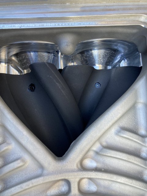

Correct but you are comparing a 3.0 to a 3.8. Gen 5 3.8 also has big inlet
My buddies Gen 5 3.8 hit as well, same spot, worse than mine. He had to grind much more off then I did.

Next hurdle, without spacers blower snout is hitting block keeping it from mating to heads and sealing on gaskets. Good thing in look for this stuff. Hard to see it, I wonder how many are going to get tightened down without seeing this and have intake leaks and stress out into the blower housing!??
View attachment 118462 View attachment 118463 View attachment 118464 View attachment 118465 View attachment 118466
Surgery time
View attachment 118467 View attachment 118468
A little paint and like new again
View attachment 118469 View attachment 118471 View attachment 118470
My 4.5 hit on the same area grinder the crap out of it
