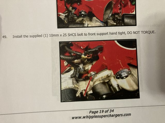

Yes, I will be boring the adapter out tomorrow to 108 mm. They only put a few bolts in the lid, it has to come off to install something inside. I color scanned the instructions with the intent of posting them but the pdf is 75mb in size, can’t even email it :(.

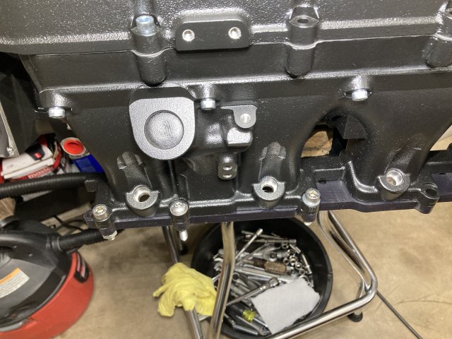

No, these are original FI insulator plates but I can add spray bars to them, I can gun drill them end to end, someday. The bracket I will post pictures of where and how it goes, took me a bit to figure out how its intended mounting is.
I will locate the plates with dowels into the heads but not into the blower as there no holes for them nor screw holes to secure them to the bottom of the blower like is done on the IHI
I was talking the screws, did they also come from nitrous outlet?
No, McMaster lol, everything comes from McMaster lol. Nitrous outlet sells them but 3x the cost, they gave me the sizes needed to use with the spacers since I bought the 63$ with shipping bracket from them.

That bracket goes here, bracket bolts to the back of the water pump flange then the flange in the SC bolts to the other hole in the bracket.

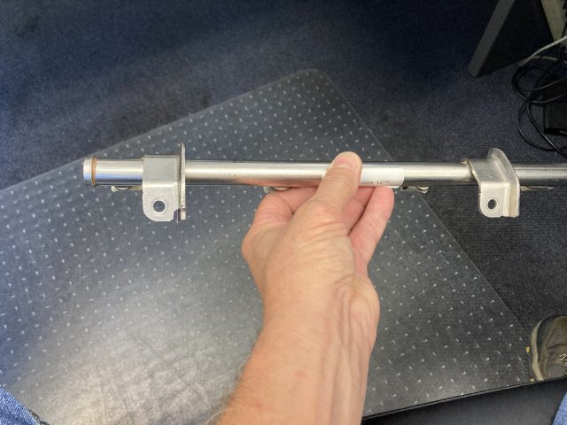

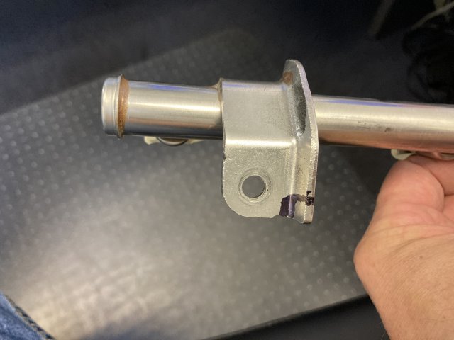

Here’s what needs cut out of the stock drivers side fuel rail mounting bracket, the instructions show this needing to be done as well.
