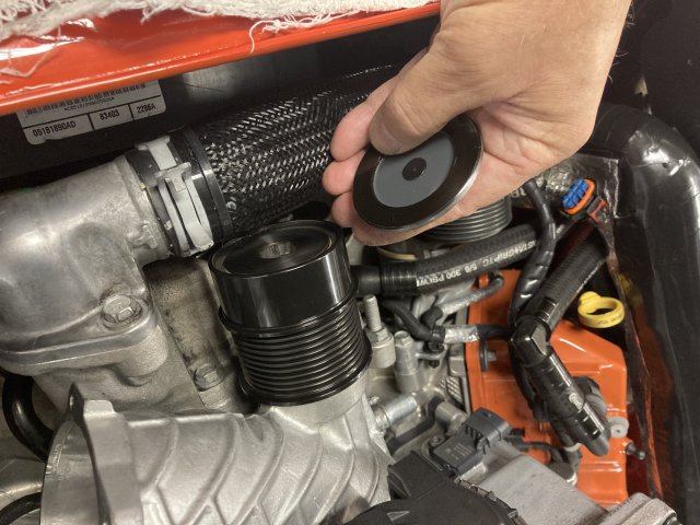

Disassembly begins!!

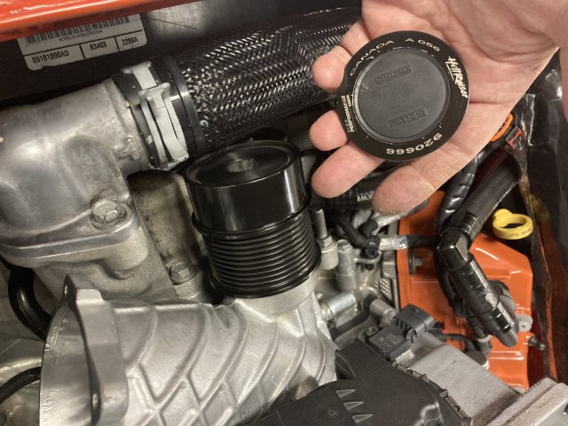

Found the pulley front right below the crank pulley, looks like it is just rtv’d in place?? Pulley still clutches fine, blower feels and looks perfect, belt is greased so that was probably the boost loss, I could have probably kept running the other night. Needless to say it’s coming off, probably today.

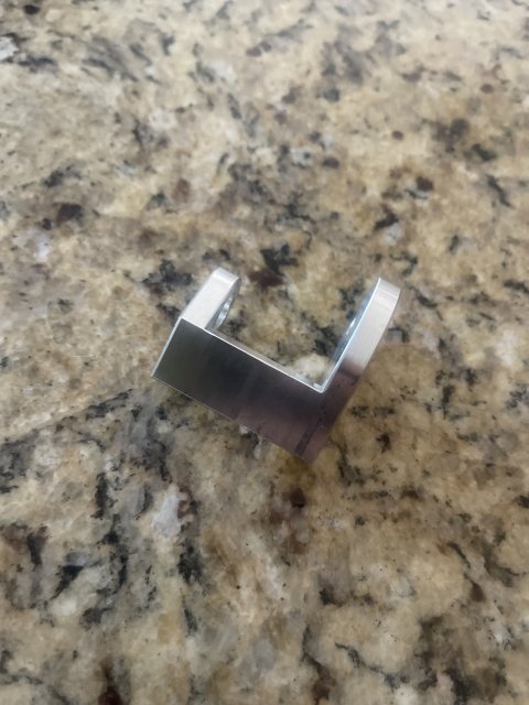

I would also use the spacers but will they fit? I guess they must if the kit uses spacers. What is the bracket for?
Bracket is for front support of Whipple to water pump, need a different bracket if putting spacers under the Whipple such as the Nitrous plates or in my case insulator plates. I have to make sure the O-rings will have the right places to seal too on the bottom of the Whipple to decide if I’m going to use them or not

You will have to take picture of that on. Does the whipple come with a bracket then for mounting?
Yes, but the bracket they send only works with no spacers and gaskets they send. This bracket was $50 plus $13 shipping 🤦🏼‍♂️
And $40 for the longer bolt kit, luckily I get the same SS buttons heads at a MUCH better price :)

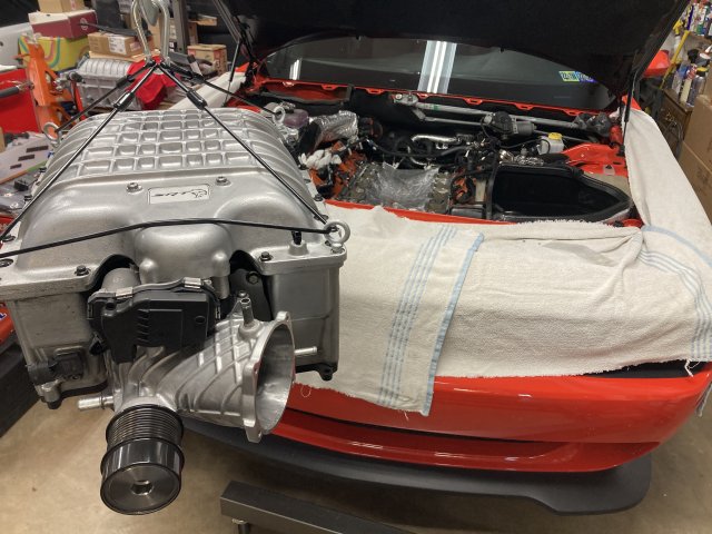

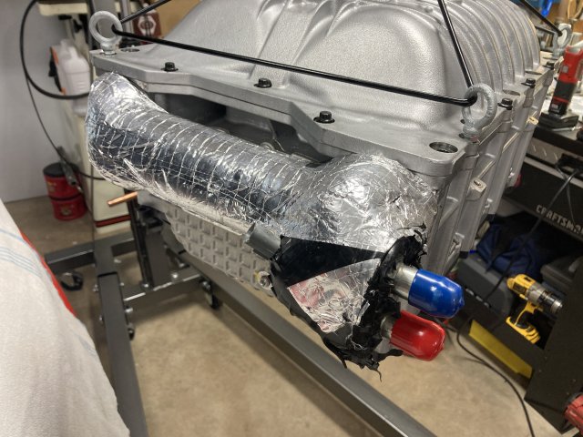

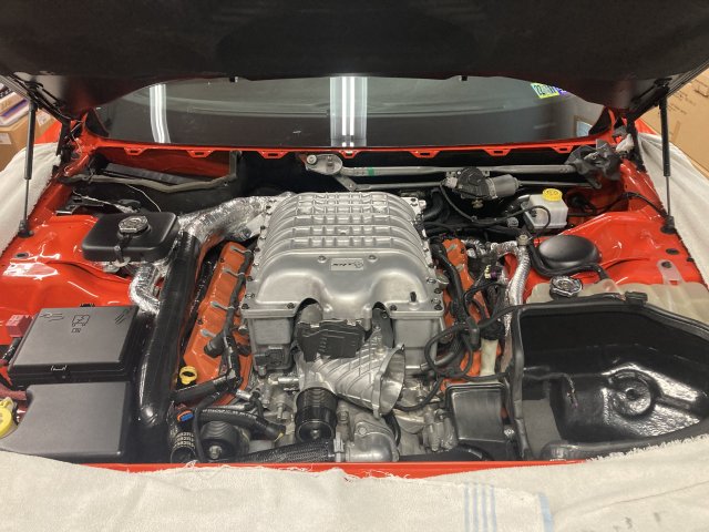

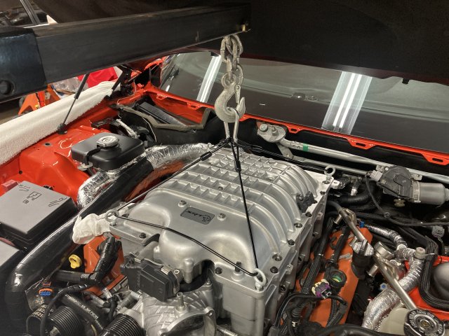

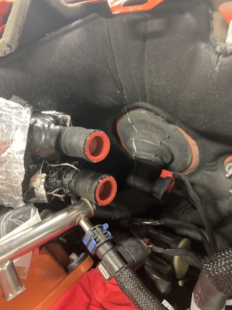

Blowers off :)

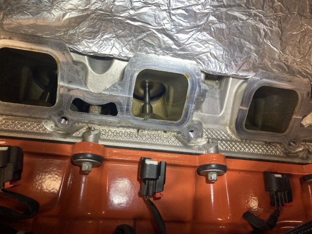

Having the proper size plugs and caps in hand at time of hose separation keep messes and fluid loss to a minimum. Devised a quicker cheaper way of lifting the blower instead of making a plate to lift from the center of the lid which I never was too keen about, these M6 forged lifting eyes screw into the blower body, rated at 750 lbs each they won’t break.
2F98695B-EBA3-424D-8DCD-4DFB162433B5.jpeg E763F5A1-392C-45EB-94FB-BF129954240B.jpeg 2BE59242-5411-43C9-BE80-46D745FE583B.jpeg 90254599-EA14-48E1-859B-83CD116FBB2F.jpeg 422E3D37-9111-4B4D-B3C2-729554001AB3.jpeg

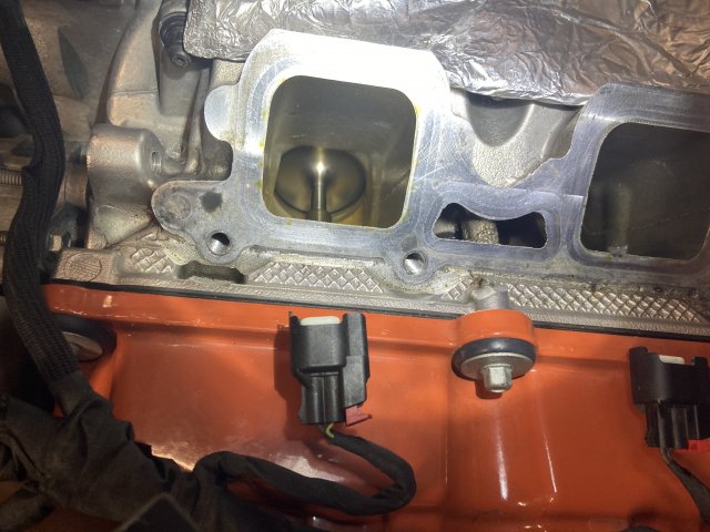

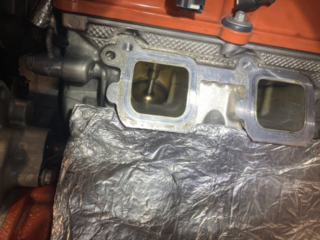

I think about 3500 miles on engine now, valves pretty clean yet, benefit's of running a good catch can!!
9B828E85-7067-4892-9679-1618CA44EDEC.jpeg C3EEBC62-228A-46D5-8450-61F26C7E0D1B.jpeg E5105467-CF36-4391-8835-5D21109B19AE.jpeg B92C2A9F-BCA2-481B-BA08-EAA3931D0168.jpeg

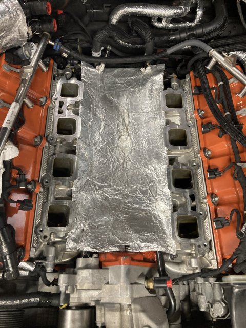

I will keep this valley insulator blanket in place when I put the Whipple on but no blanket stuck on the bottom of the Whipple I don’t think, still pondering on that one .

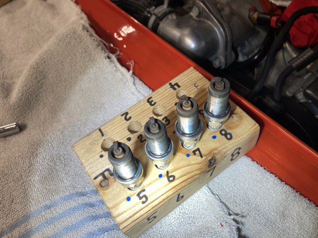

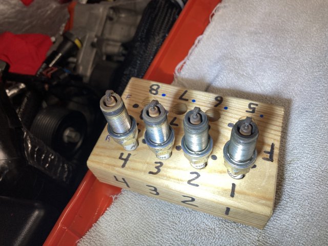

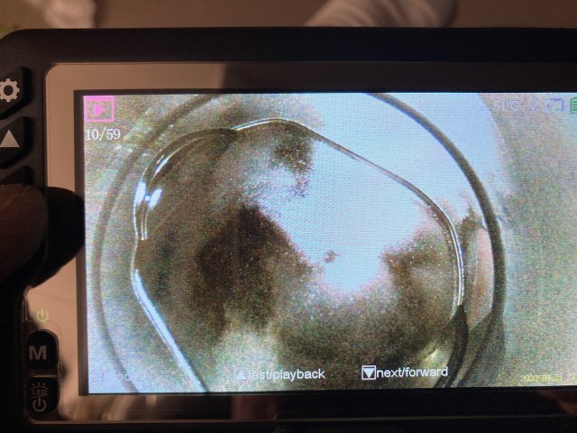

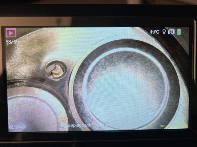

Coil packs off, 1 plug out of each cylinder, ready for bore scope then leak down test. Notice the MMT staining from just 1/2 tank of fuel with 1/2 qt of Octanium Unleaded last fall never cleaned off the plugs, it’s the same every where else it collects, only one thing removes it, abrasive cleaning. Glad I’m on clean corn now!!
ACB4E9F8-03A6-44BE-9688-CC233ACF4C4D.jpeg 4CD70558-10CA-497C-85E8-1A4863C793F2.jpeg

I think you just want an excuse to play with the New bore scope
3,669
8,624
Thread Starter #934
No, you all know me, I gots to know!!

Blowers off :)
View attachment 79480 View attachment 79481 View attachment 79482 View attachment 79483 View attachment 79484
View attachment 79485 View attachment 79486 View attachment 79488 View attachment 79487
You need to get one of these to help remove the blower . Works well:) 20220513_125546.jpg

You need to get one of these to help remove the blower . Works well:) View attachment 79515
Not needed, I lifted it off with one hand.

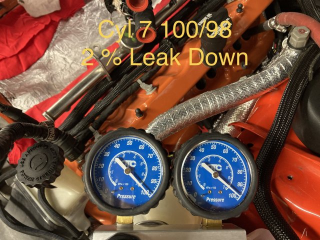

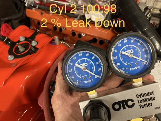

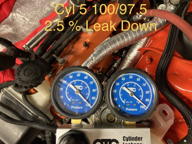

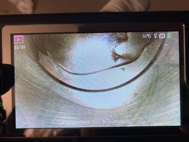

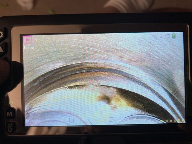

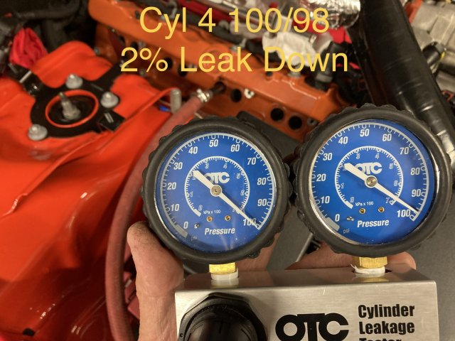

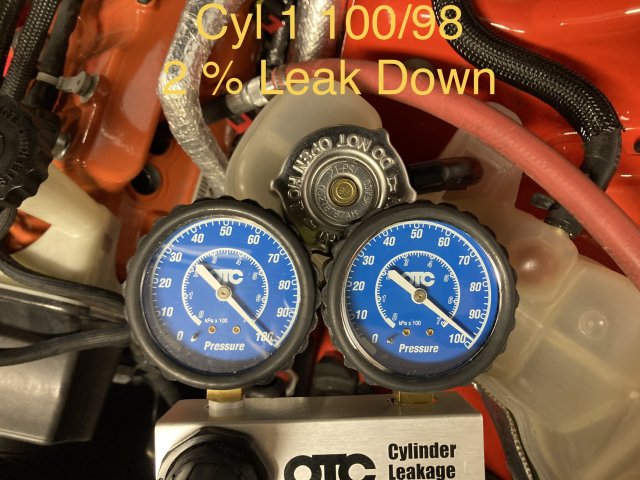

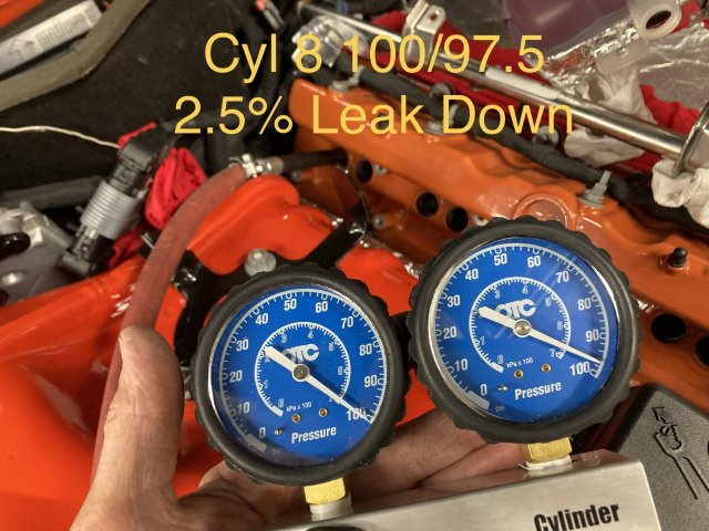

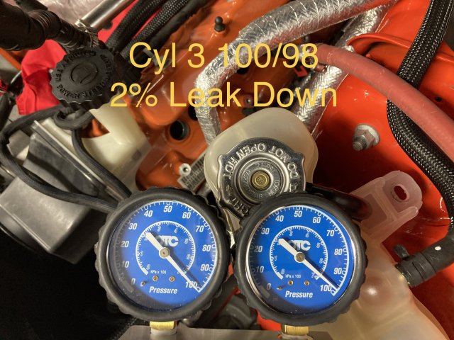

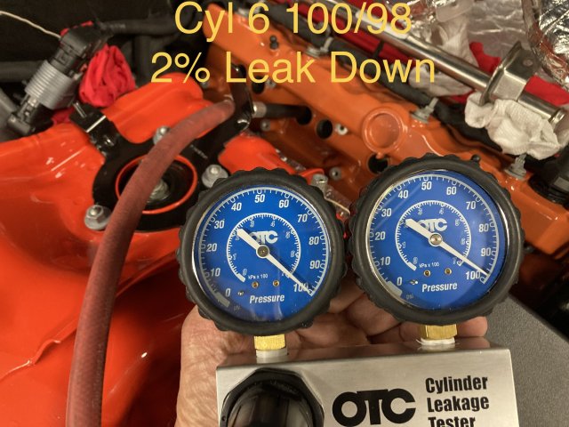

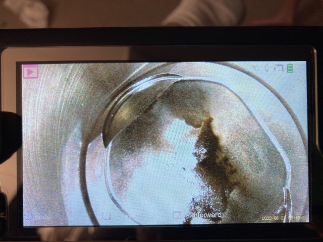

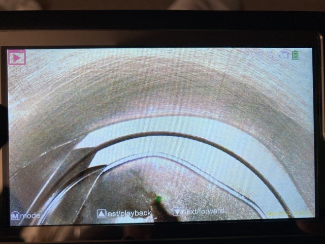

Leak down test says PROCEED :)
Very good for a stone cold engine with big ring gaps. Actually gotten better since the last test 1000 miles ago, I think she’s fully seated in now, 3800 miles since the rebuild.
5D4B4813-9104-41D8-8DBE-252048C255B8.jpeg EDB02C46-1A29-40B1-8C2E-0984CBEB1708.jpeg 2E8530EA-B1C9-4613-9551-5DA1BCB09E1D.jpeg 9537A447-9772-4D83-857B-F1F0B183000D.jpeg 2B3EC9E3-3ED4-4CDA-A975-6A3A5D56F24D.jpeg D36A751F-AE61-44FA-A0E0-DCC5A9F891E8.jpeg 0ADC50E9-C0DB-4458-B56B-4965BE7920B8.jpeg 21A498F0-7F0A-4E6D-AA7C-DD4297B5E6E6.jpeg E60DDCF6-CF76-45FB-9053-D87057ADEE13.jpeg
All the cylinders looked like this, clean and perfectly broke in. Happy to see this!!
1FA0424F-539B-4487-8497-5065DF058A8F.jpeg AEB3C1F0-6B78-4247-9B26-FF495C4BFDA0.jpeg 66BD5FBE-72F8-47A7-8F32-4D8E48D191A5.jpeg D90A3A55-4B91-4668-A097-A5D74A773264.jpeg 5F0BA840-D4BF-4DC7-8883-6AA4B6B5374F.jpeg 58767824-C1FC-45AD-B7A9-684A4A86B0A2.jpeg
