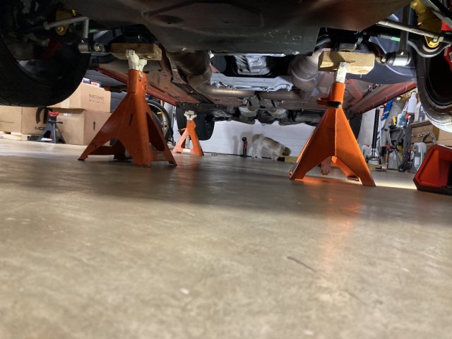

I did an oil change with my pup in the garage earlier. I swear it tacked on a half hour. He kept trying to take stuff. Believe it or not I’m not 100 percent sure where my 10 went
My guess it’s in the yard somewhere after a day or so of digestion lol

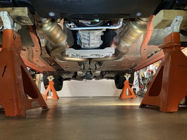

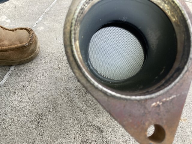

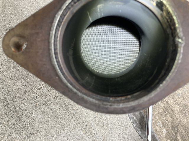

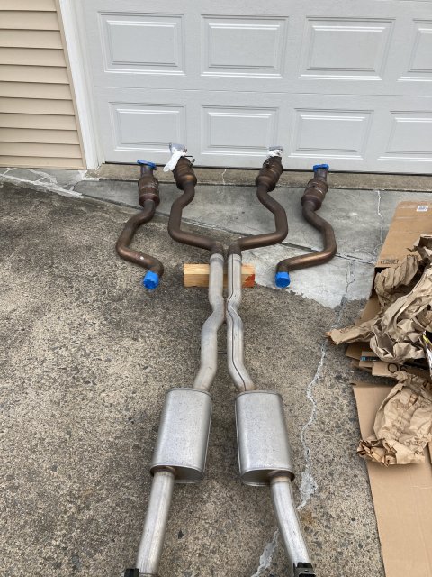

Changed the cats out with 100 mile off the show room floor take offs. It’s amazing how much tighter to the floor boards the exhaust can be when done right.

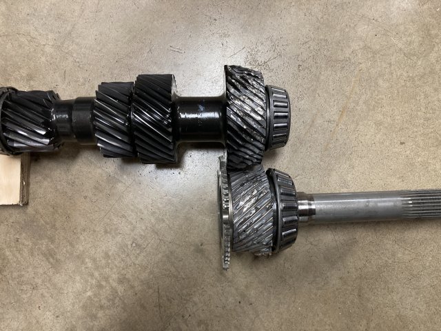

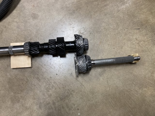

Check out the input shaft gear, I don’t know how I even had 4th gear to get how with? I think I was driving on the synchro ring?? E3B258F3-E3C5-4C0A-AC01-C66C02DD76F2.jpeg 9B057136-2F15-4693-83F6-435E40F3AC51.jpeg 9F901C54-2B7F-4A23-906D-44EC8A7F6A91.jpeg CFFF37E8-E83B-446F-8110-87A50D171CD5.jpeg 6C569016-0F94-4892-AD52-C5586F4A9A70.jpeg 69D8477E-6FEB-445E-8B94-761884E79A52.jpeg 78DCC539-669E-4C03-9722-78E741E706C2.jpeg 1FF1A54A-D6A4-4CA7-B0A6-0169EFEBC914.jpeg 93056A52-E589-4258-B210-23F69E34F377.jpeg E88EAFC8-34B9-416C-81A5-ACA8DD9E3CAF.jpeg

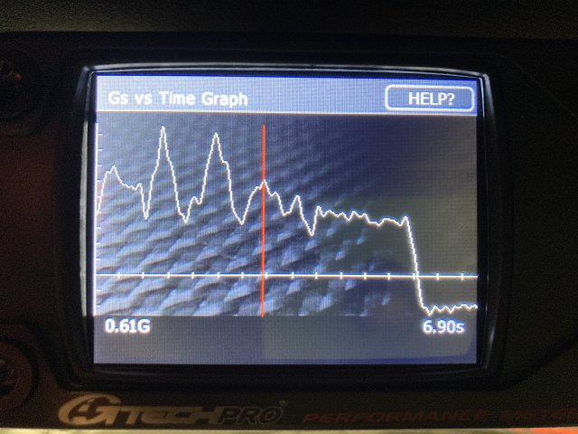

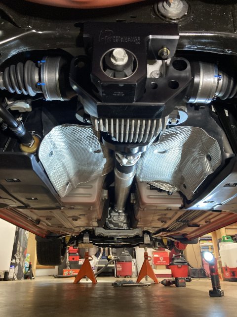

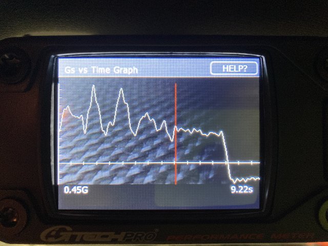

Well I can say this gear ratio pulls no where near what the 2.10 second 1.43 third pulled like :(. Third used to pull .75-.80 G’s of acceleration, get .55 now :(. Guess a 3.90 Diff will be in my future.

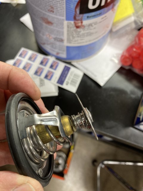

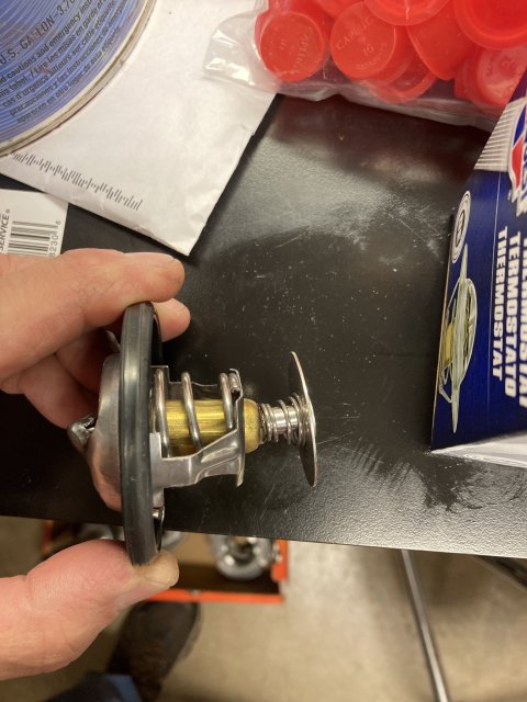

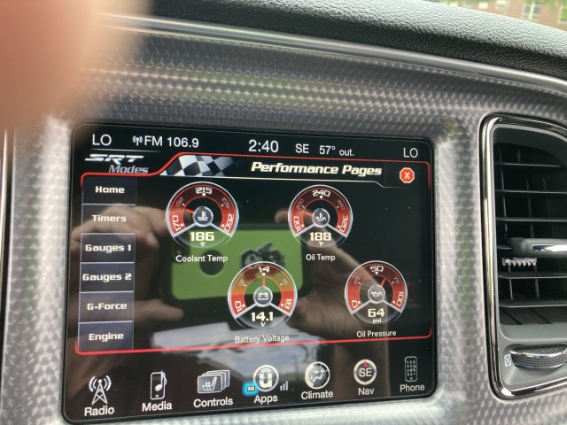

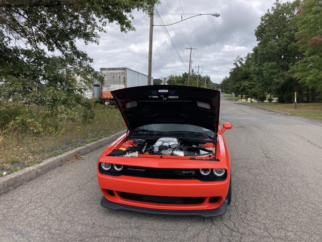

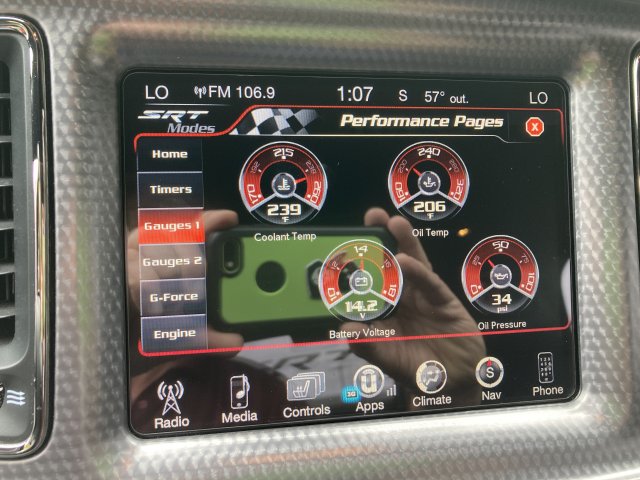

Speaking of temps. Well so much for Misimoto Tstats being the best. Did a 3-4 tuning pull, all was well, then noticed coolant temp creeping up, 205, 210, 215, 220, started looking for a place to pull over, luckily a dead end road right ahead. Pulled over, opened hood, fan running on high, 225, 230 shut her off. My heart sunk yet again, first thoughts popped a head gasket, no way, studded. So started poking around, lower radiator hose stone cold, f n stuck Tstat. Luckily there was an Advance Auto a 1/2 mile down the road. Got a new 180 CarQuest premium Tstat (Motorad in the box), bought a cheap 13 mm box end wrench, picked up a gallon of distilled water and box of 1 gallon zip lock bags to catch the coolant and changed Stat on the side of the road. Hour later back on my way. So I guess the motorad is staying in there as it’s actually doing a better job at stable temps then the Misi, lesson learned. Plunger blew out of the thing, WTF!!! 74EA7516-CB9F-41F1-8C11-3ED800009A64.jpeg CE4F2E35-8D45-403A-89FE-5CAD4E3A90B4.jpeg 3C44ACAE-70B3-4B5E-9902-79B939A66F89.jpeg 2E4FB102-3B58-4080-B129-CB5216ED7EAD.jpeg 8087CEBA-E024-4155-9B6C-3111EFF269E0.jpeg D8DB8C78-BB5E-47D4-A4B1-BBA354C888C1.jpeg

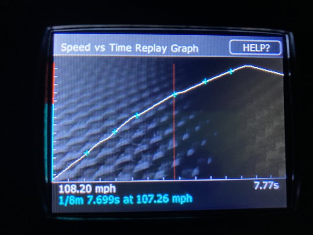

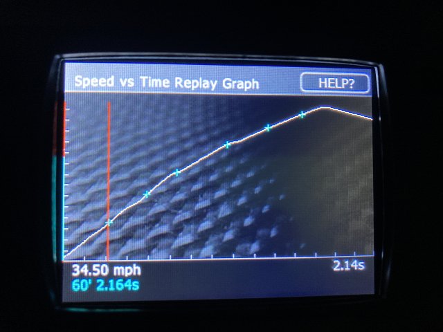

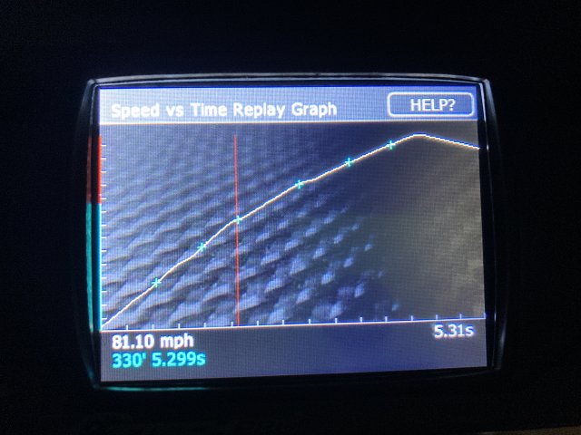

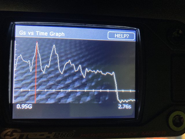

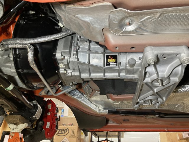

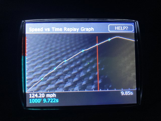

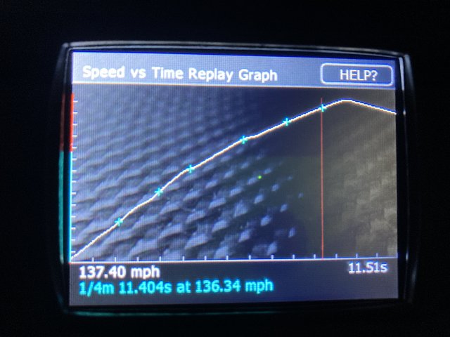

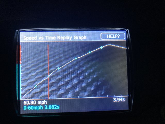

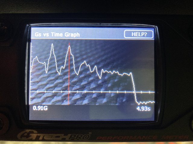

So let’s test the Motorad, ran few street 1/4’s last night, finally getting used to launching this new trans. Getting close to my no burnout launch from anything any time 10 second street 1/4 goal. Almost 1 G in both first and second, damn I miss my 1.43 .75G pulling third gear that would sure be of help to the quest. Guess have to increase the POWER now somehow lol
This new Tranzilla with REM polished shifting intervals does shift like butter just like the builder told me it would, hats off to Mike at RSG 👍
BA4731B5-1CD2-4A16-85FE-2E0D6330B0F0.jpeg F2817DD0-B392-4738-97D0-03AF45E6C7BD.jpeg 567955A7-961C-4D7D-BA2D-A2D4A5BAB614.jpeg 780B1086-79C7-4BA5-9E7B-D7AEF83E8E09.jpeg 041307E2-5115-4EBA-BFBE-D9520DA341DD.jpeg 4BA5F7C9-7056-4A1C-85B9-EB0AC757F024.jpeg 603DDEF5-C54F-4EC2-9F7E-E92228672355.jpeg EC311668-4CE5-41A0-8B3C-383375AEB5C2.jpeg 9441176E-3C7C-4937-B24C-C50166B3639F.jpeg F6675F9D-ED87-4F3A-9855-37F4DB09D094.jpeg
