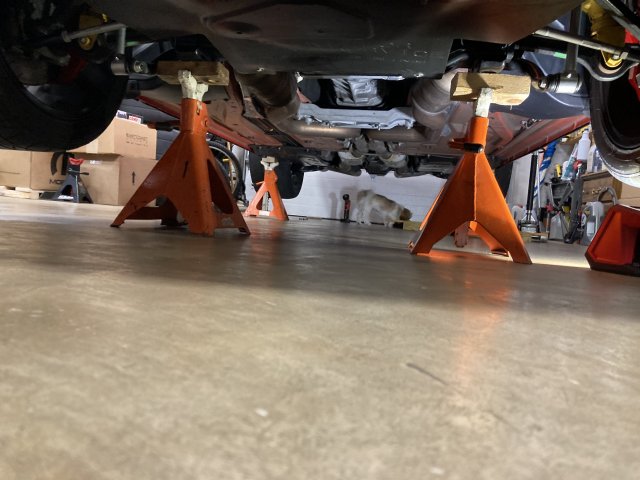

Well here we go again, tranny, Diff, and axles, I really hate mopping this garage floor with my ass lol.
My little buddy is ready to go lol, she’s already looking for what she can make off with lol

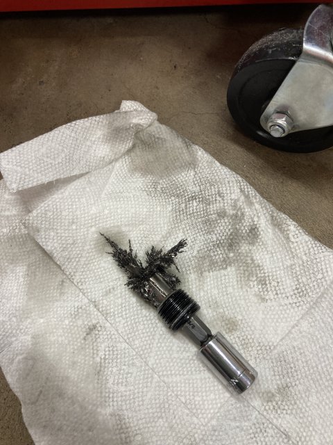

It’s out, magnet shows some of the debris but I’m sure way from all of it lol
Next stop RSG for all new guts.

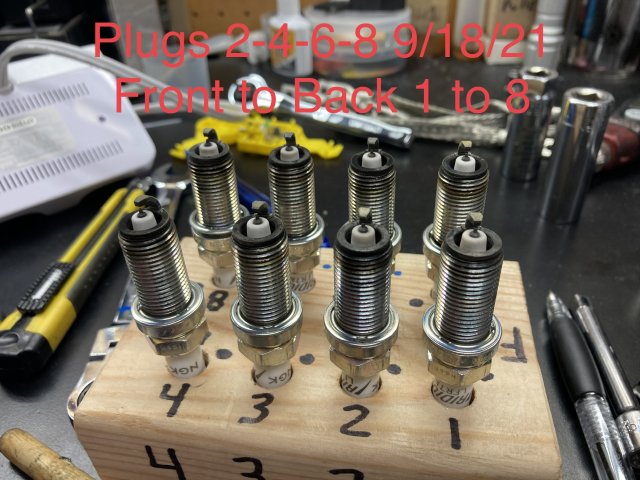

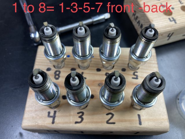

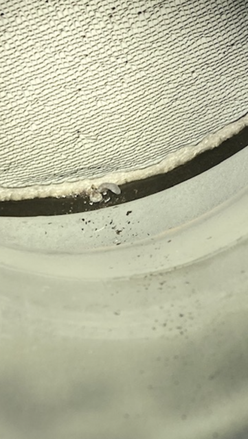

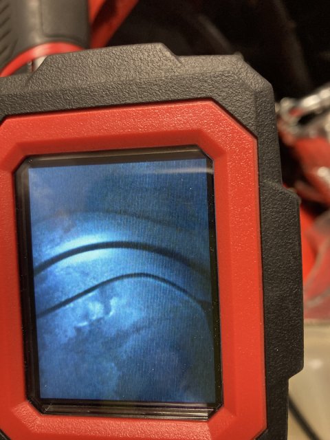

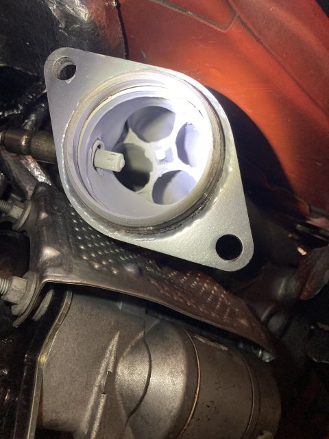

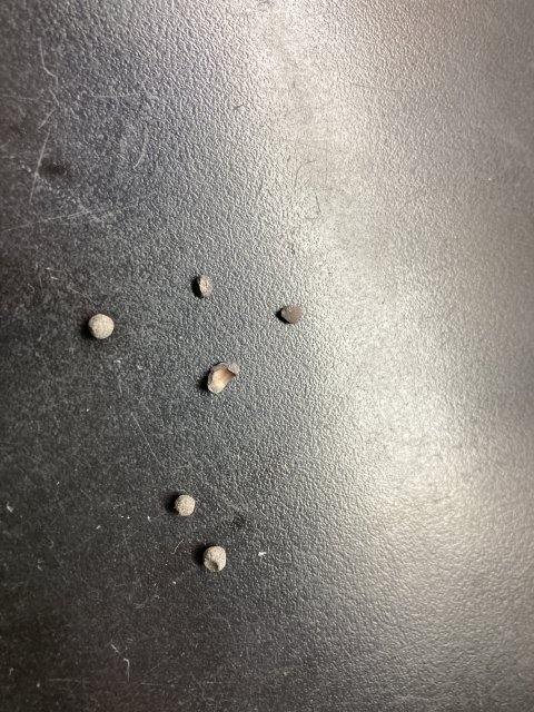

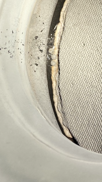

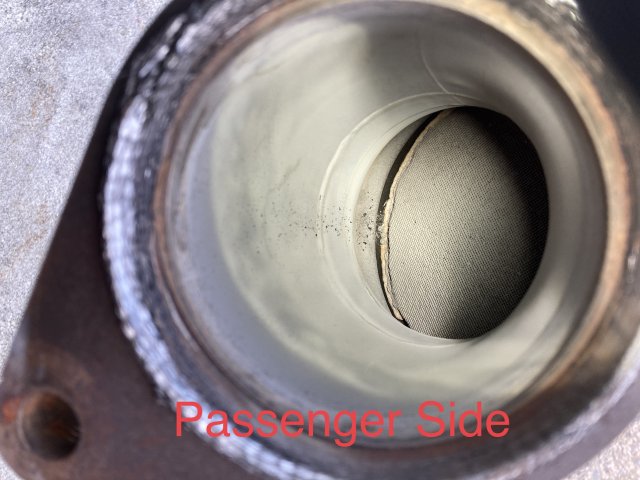

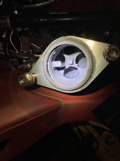

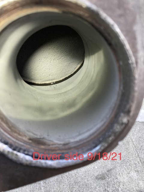

Had a scare when I looked in the cats upon removing the exhaust system, bits of spark plug porcelain :(
Which delayed trans removal to pull all the plugs, they all looked like the day they came out of the box thank God, whew!!!! I was sweating it with each plug removal waiting for the bad one 😅

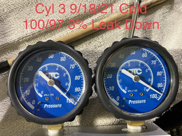

Did a leak down test on all cylinders as a just in case, weird all the ones on drivers side exactly the same at 3%, 100/97 psi, passenger side 2 at 3% 2 at 4%, this a cold test, 68F in the garage. So now I have a base line going forward. Bore scoped each cylinder as well, amazing how clean corn keeps everything including the exhaust, I wiped my finger around in the collectors and didn’t even get grey dust on my finger.

Did a plug ever fail? Could that be material from the cats?

I just did the plug dance, after seeing how clean yours are. E85 might be just the ticket.
2 years ago had a detonation event from bad gas, 2 and 7 had plug damage. I’ve had this exhaust off a few times since and looked at the cat elements closely every time and before putting it back on after the engine rebuild I even blew it out in reverse with a 700 CFM back back leave blower and inspected it pretty damn well, no idea where these bits where hiding at in the cats. That’s why I was so concerned when I saw them and couldn’t continue on removing the trans as I had to know if I had a melt down again snd if entire engine had to come out again or not. You have no idea how glad I was to see 16 like new plugs and good leak down numbers from all cylinders :)

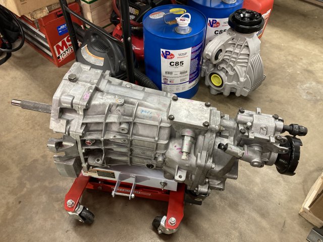

Drop the trans off Tuesday for a hopefully pickup this Friday. This week while waiting on it change out the Diff and put the new axles in and hopefully be back in the saddle by this time next week 🤞🙏
Zoom in on the pic’s of the cats and you’ll see the bits laying in them, that’s just how they were when I removed the exhaust. I have 2 brand new cats that I’m putting back on and trading these 2 originals in next month at the cat recall visit along with the 4 original O2 sensors to replenish my stock :)

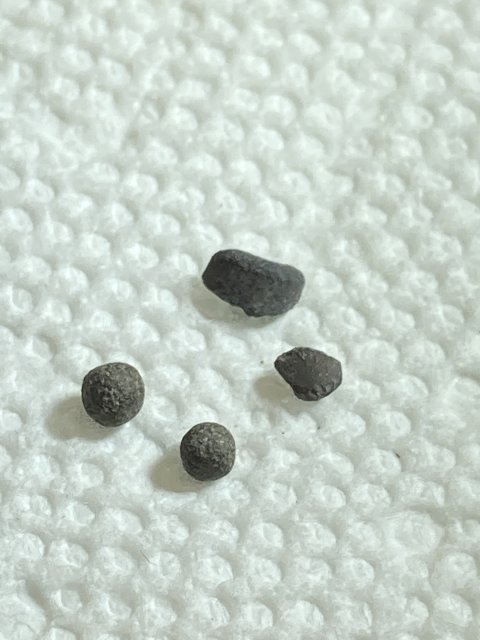

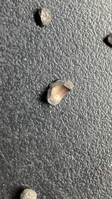

I thought the same thing at first but look at this piece in the center of the bits, it’s a piece of spark plug porcelain no doubt. And the other round bits look exactly the same at it composition wise. None of them magnetic and they don’t react to a acid that would eat them away if they where aluminum from pistons. They round ones got round from twirling around in there a gazillion times just like pebbles in a stream from eons of rolling around in a brook. I just thank God their eons old not new :)
