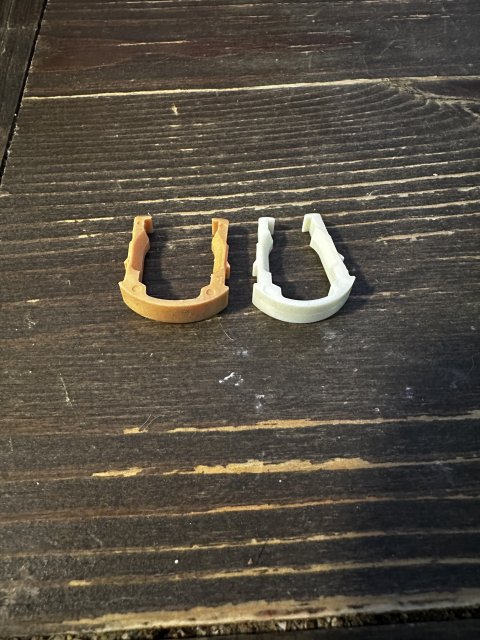

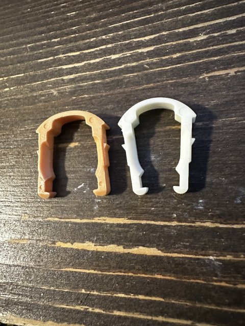

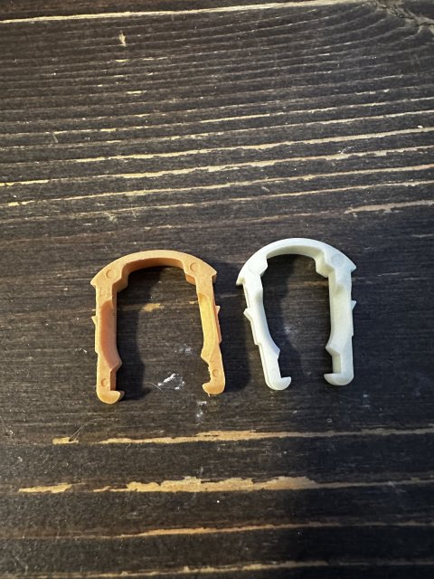

Perfect fit.
Old on the left, new on the right (white). The old one used to be white. Looks like e85 took all of the tension out of it! Car is fixed 😎 60+ psi at run, and 70+ blipping the throttle. Around 57-60 idling. Drove it around, fired it up/shut it off several times and logged. Calling it good. Hopefully this helps someone else. Thanks again for the suggestion @catdad. Was very lucky only 1 Oreilly had one of them in stock, no other stores
and yes, I got all of the dirt out, tank was all but empty

If you’re having fuel pressure issues and run e85, check that clip.

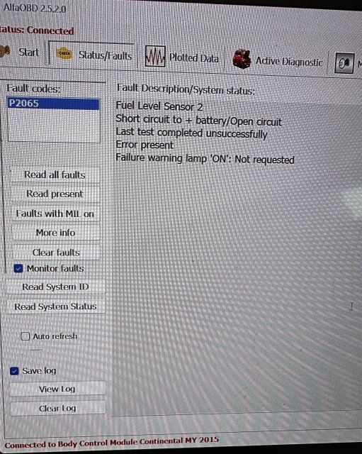

Hmm, so which one is #2? So this doesn’t show a CEL, gas light just flashes and “server fuel sensor” message shows on evic
U
8,659
7,634
Thread Starter #69
Tell me I replaced the wrong one 😑
fubar569
#1073
1,431
2,095
Bradford
#70
Yeah. You did.
