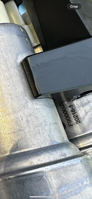

Not sure which pumps they are, can’t see. Whichever ones I jected engineering had in their Gasahol kit 5 or 6 years ago

Thread Starter #29
3,752
8,909
Number you need to see is under the black holder starts with a two you can’t see the next two digits. If they are five or six years old and the filters were black like that, they need replacing they’re probably not flowing nowhere near what they should be.

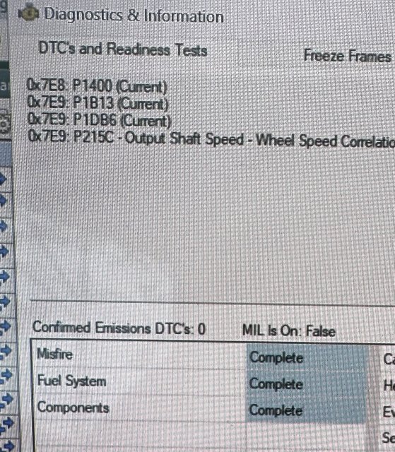

Zero fuel pressure in run and 0 while cranking 😑
U
8,659
7,634
Thread Starter #36
And just some vehicle speed etc related codes from it dying in the middle of driving
U
8,659
7,634
Thread Starter #37
So I’m thinking the inline fuse or relay blew for the pumps. Still not sure why. Still getting the BCM message flashing “service fuel sensor” on dash (which is a fuel level sensor short U code) and fuel light blinking. Pretty annoying, replaced the arm to correct that issue (message coming on and gas light flashing every now and then) and now it’s full time/car won’t start
