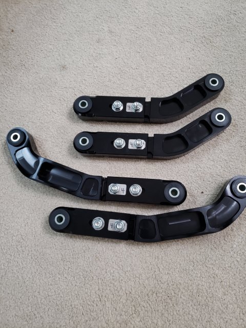

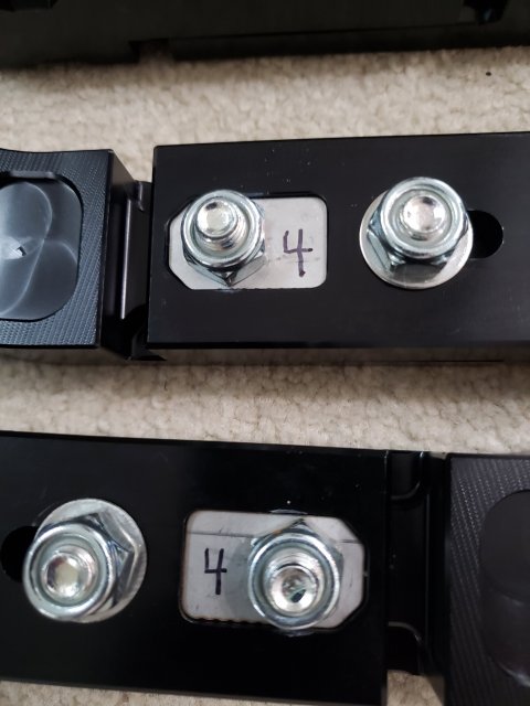

Going to do my arms this weekend or next. I decided to start off with the 4 tabs 20220518_173526.jpg 20220518_173529.jpg

What was interesting in the instructions is it said you can make all your camber adjustments with the long bar (one next to spring). I would think they both need to be the same but that isn't how it reads. I just started with them both the same
That call gets interesting. I would start with both the same. If you run into toe adjustment problems you can start playing with the “front” arm, but that is a dark highway. I spent maybe six weekends all together screwing with the alignment and those tabs, since I have the whole set. But changing out just one of the two sometimes returns surprising results, like N/C!!
