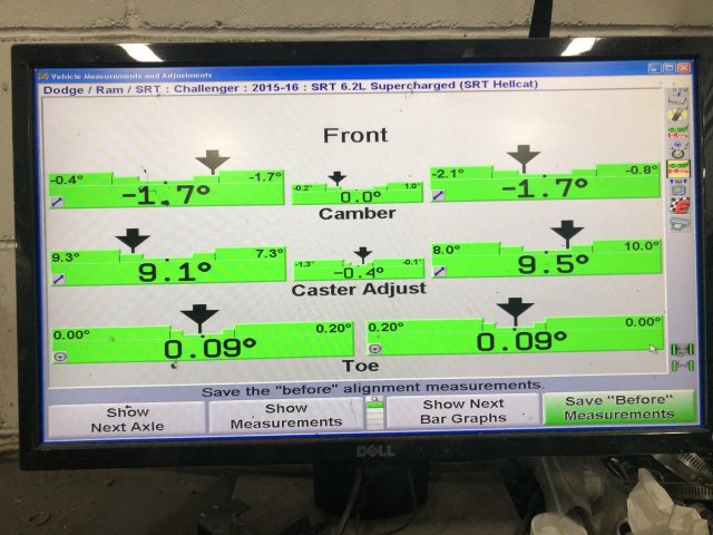

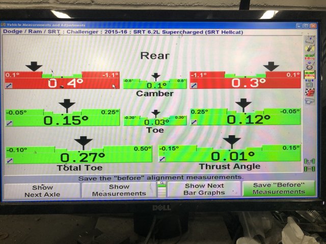

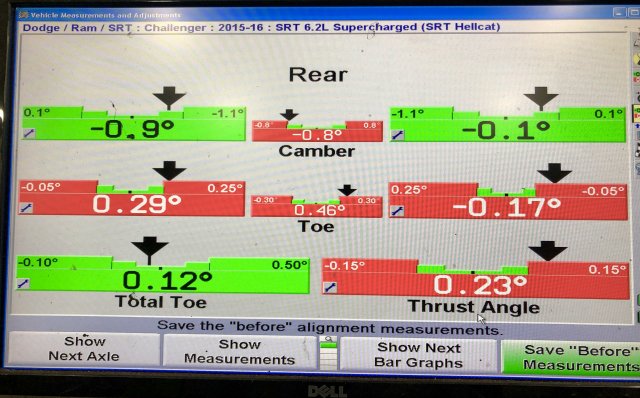

Alright. So I’m out of there. I was there for 5 hrs. he charged me for 3. Yes, 150.00/hr as he advised me from the start. Total 488.00. Below are my before and after rear readings in addition to the front. I haven’t played with it as I had to get right to work. I was looking for as close and flat as he could get it bearing in mind a few of the thoughts you guys suggested here and the other place. Thoughts pls. Thanks.

Front is easy, have him slam the camber and caster tabs, in check it. Anywhere near the specified camber will work. Then simply do the toe, which takes ten minutes in my garage anyway!

I think you will like it.
I really like the front for the street, your tires will last forever.

That really isn't bad for a first timer and a 5hr crack. The numbers look pretty good overall. I personally would like to keep toe close to 0.10 and if you want to get closer to 0.0 camber go down 1 tab on each side...so if you have 7's go to 6's. Each tab is ~0.20 degrees adjustment or thereabouts...but all that is just being picky. On a good hard launch that should plant plenty flat for you.

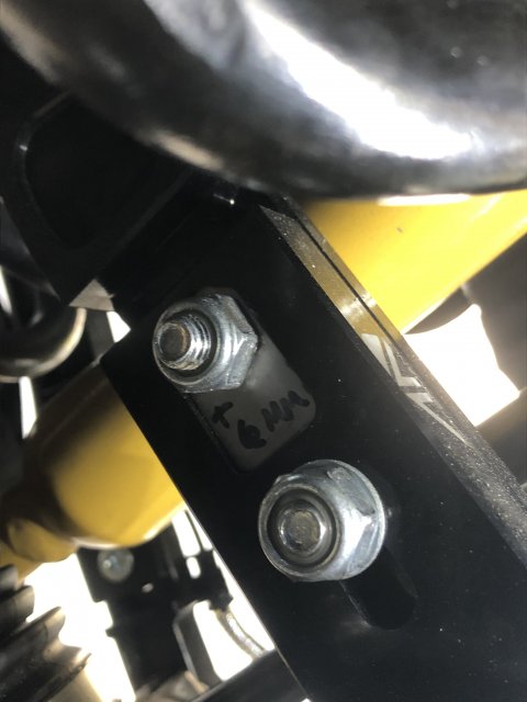

I kept a count of all the tabs I dropped off and their values. Looks like they removed 2 “0” mm and 3 “2” mm tabs and replaced them with 2 “6”mm and 3 “4” mm tabs. As supplied from AAD I asked for stock length arms and compared their length to the factory parts I removed to confirm. I’m going to get the car on the Quick Jacks this weekend just to check everything, torque values, etc.

IIRC the rear arms take 1 each and so do the toe rods if you did those. So 6 total for all 6 arms (trailing arms are fixed length - they don't count)
Likely this means your arms not only front to rear but side to side are all a different size. That can happen but isn't very typical. Usually the upper F/R arms are the same length per side. So your L will have matching tabs and so will your R. Typically. Each car is different.
What matters is that you verify what tab is in each armand write that down for your records so you know what to change each one to...and which ones to order if you need more.

I hit each tab with permanent marker so I can easily record their value while on the car. Hopefully the markings are still there. I will see over the weekend when I have the car up.

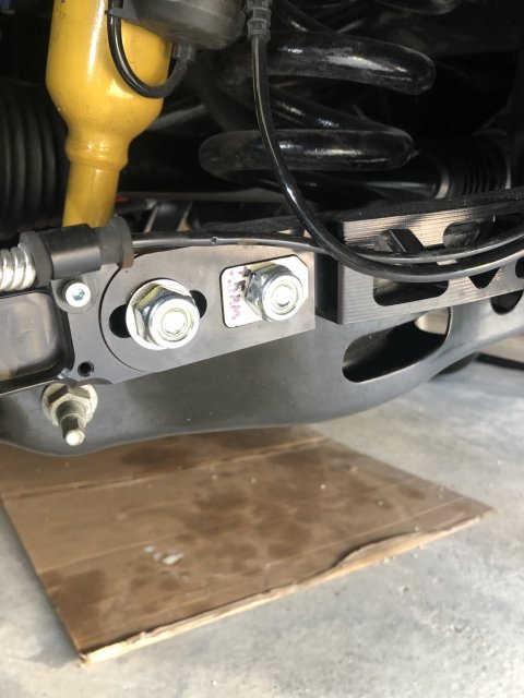

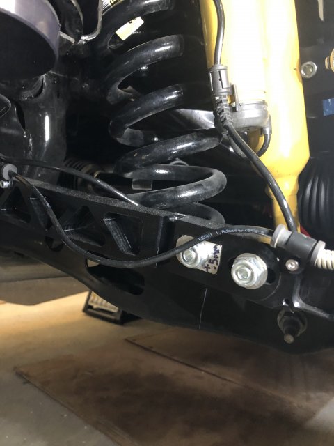

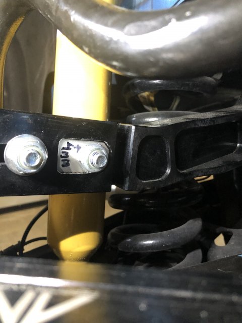

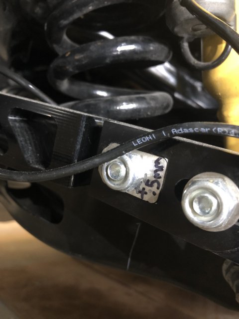

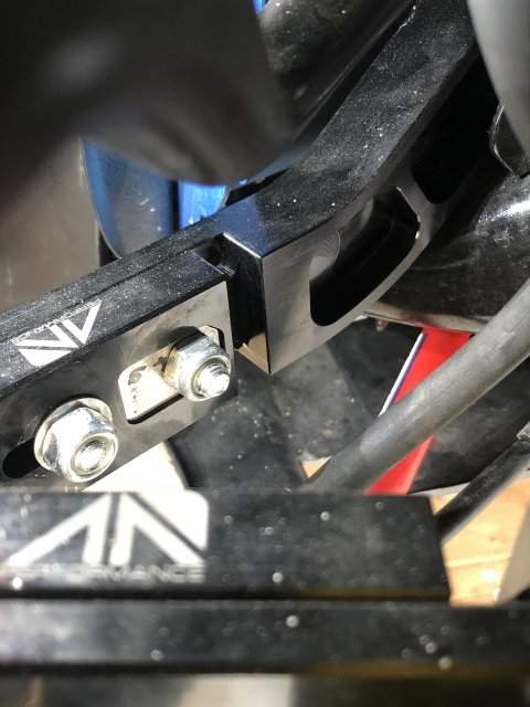

@vortecd under the car today. +4mm on either top arm, and +.5mm on the longest bottom arm. P/s pics first:
B186CB02-8966-4AB6-B3A7-BEA50592D570.jpeg 9C7A6F24-891C-4FB2-A0C1-490DE719FB89.jpeg DDD0B51A-7915-4E79-A618-7B759A1AB887.jpeg A766CEAE-ECA8-4210-8802-C6A84A6183D9.jpeg

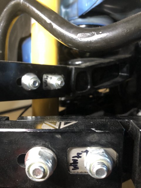

On the d/s both upper arms took +6mm with the longest lower are taking another + .5mm
5F4CEB95-0E86-47A8-A8AE-ED36A4C24577.jpeg C4BD940A-8B37-4531-BCE1-50779B4205C0.jpeg D3988D3E-CBD3-415C-B87A-F1D8B14DC5FD.jpeg D8A177A0-1222-4A15-8A6C-690489AFDC69.jpeg

That's less than my car took. I needed 6's and 7's.
Glad to see the toe rods needed minimal tweaking too. They must be pretty close from AAD.
