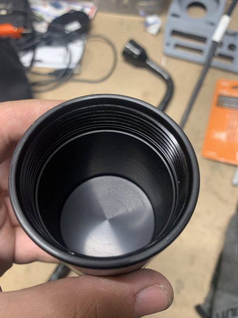

Not to resurrect a potentially dead thread but I just checked my catch can and not a damn thing in it. Stock 6.2. Daily and race it. Taking it off. Also for sanity check blew through the hoses. Nothing blocking in either one.

You dont have to go to that much trouble to find out. If your car puffs a little blue smoke after sitting over night when you first start it up. You need a catch can. Or you can pull the throttle body and look down the cats throat and see if your greasing it up. I say you are, to some degree, if you dont run a can.

Mine has about two tablespoons of oil between oil changes.

I put a upr can on mine as soon as i got it home. It had 164 miles on it. At first i got more in the can than i liked. Maybe 1/4 full after 2000 miles. Now with a wopping 7000 miles on it i hardly get any in the catch can
ng to worry about. You can test to see if your PCV is working at the valve cover but just goes to show you everything is tight and youdon’t really need it on these cars. My 5.7 was way different. It fills up between oil changes.
A 6.1 I had would pool a little in the lower plenum of the manifold. The 5.7s I had at work would pool up a little too and when the guys would back down our ramp to book a detainee, they'd go out and start their car and some of them would puff a little smoke.
My point about our Hellcats is more based on the way different valve covers that are designed with the big oil separator area (so to speak) built in. Without a catch can, where does the oil pool up, at the front of the blower or in the upper plenum around the intercoolers?
