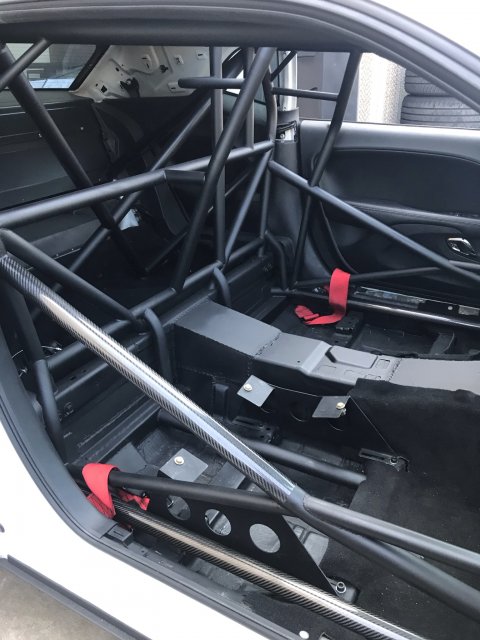

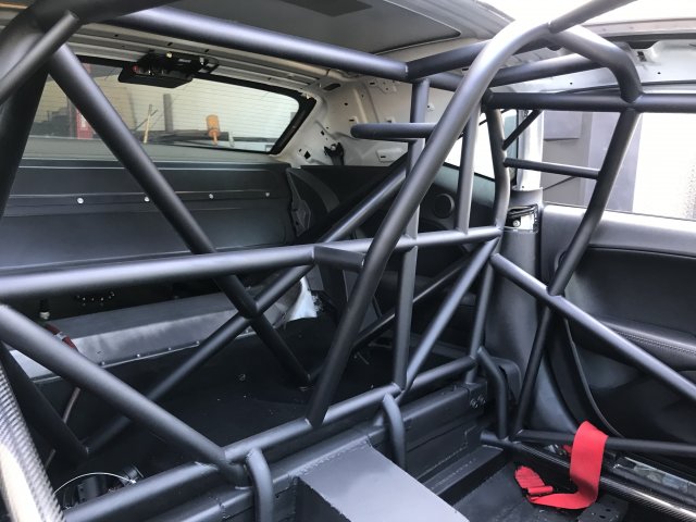

The subject of cages in street cars is something that will always be argued. Street cars that can run in the 8’s at over 150 mph is something that in the past would have been a laugh. A 8.5 cage that is custom made isn’t intrusive in the front seat area. The door bars can be swing out or be removable. What it does do though is block the curtain airbags with the overhead bar and your head needs to be kept away from that bar. That means you should be wearing a harness to keep that from happening. It’s one of those things…. As long as you consider the risks, than you make the decision. America!! When you go below 8.5…. Things get much more complicated. It starts to look like this… B04D16C9-8214-44E7-9BAA-20E22168364E.jpeg 3E699B00-A6CC-4A66-B0E5-21E2FA229BBA.jpeg

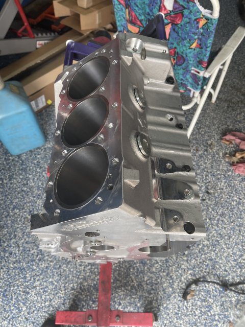

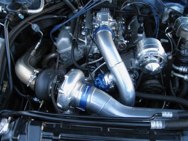

Looks like a TA Aluminum block to me lol. Ur not messing around. Sweet!
Kenny Duttweler is a great friend
