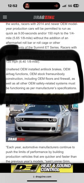

People also need to read the cage rule jon brought this up.
8.99 and/or 150mph a cage is needed
add taking out seats you are removing air bags need cage
light weight brakes are not factory need cage
15 inch rears need cage
There never was anything on brakes unless something changed. So you are not removing a safety devise being it still has brakes. I always that it was strange you can have drum brakes and go 150mph:unsure:

Also cars were sold without passenger seats
It still will have antilock brakes so they would be unaltered in their function
Smaller lighter brakes are not factory.
cars without pass seat still has working Air bags in drivers seat. When you remove drivers seat or pass seat with cars that have two seats you changed safety system
60,928
212,786
Some cars were sold with no passenger seat so that is a grey area. If you are not disconnect the airbag it is still there
60,928
212,786
Another grey area on brakes cause I read it as the antilock function needs to work
Roger that on the drum brakes. Always made me chuckle, even back in the day.
4,385
10,906
The air bags do not work when you move the passenger seat. You have to buy a plug to make them work.
60,928
212,786
If no one is in the passenger seat do that side even go off in an accident? I was thinking on the plug, Ron sells those
20,161
So removal wo the plug disables the entire system? Thats good to know.
8,663
7,635
I have a lot of weight removed, airbag system is still active. If you’re competing, then you have money for a cage and don’t care about welding a cage in your car. If you’re doing test and tunes or “private” competitions, up to tech but don’t run an 8 and you’re fine.

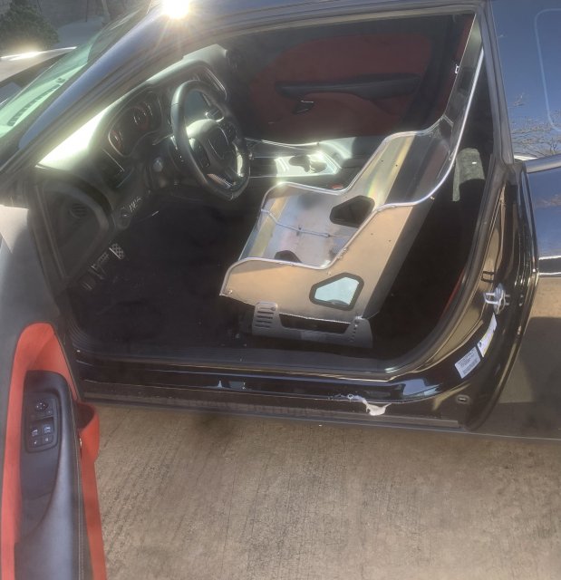

At the end of the day what’s your life worth? Guys want to go fast a part can break at any time. How many have a diaper? You can break the beams wait a little bit then go 150 out the back. I don’t want a cage in my car but as fast as my car is it’s necessary even on a track rental

No my daily is a C7 corvette in summer. Hellcat gets about 2000 miles per year.
and a cage is just more than roll over it’s also about impact. And making chassis stronger
