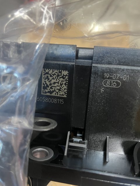

shifter was put in, code didnt go away, car goes into limp
i have a hp90 tcm but getting on mikes schedule has been hard, everyone is getting ready for MIR and the mhsh so they have been taking up his time, sadly my car is not a priority
996A1B17-EC48-44CF-9C41-6C20332897C7.jpeg 8DD16554-2725-4046-9A39-68FD49214B1B.jpeg
as i told @jonx96 the car is dead to me. I put it up on FB marketplace for 55k without trans, once the trans is fixed and the car runs ill just take it to carmax and take what i can get, i truly hate this car
