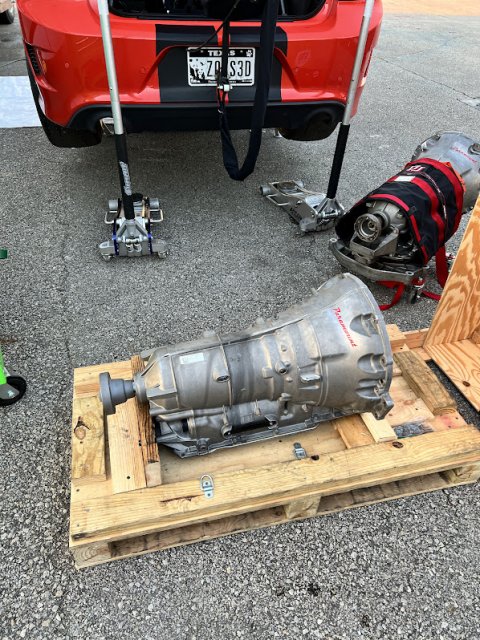

At TX2K this year in the parking lot, I used a Harbor Freight low profile trans jack on jack stands. I just needed to lift the front high enough to slide it out from under the car.
