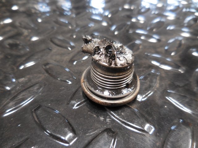

Some of you may remember I tried to buy a Ram 1500 but the 5.7 was eTorque only. I hate anything E, so I passed. I bought a new F150, and I have been disappointed many times. Most problems were minor, but today might be the tipping point.
About 2k mi, I did the first oil change. While I was at it, I checked the diffs and transfer case. Front diff tool a couple oz. Transfer case took maybe 6oz. Not too bad, good thing I checked. Then…
I removed the plug from the rear diff and it looked like it had a lump of black moly grease on it! I’m thinking WTF! I roll out from under the truck and take a look under good light. I wipe it off and I see the fill plug has a magnet staked into it! I never heard of a fill plug with a magnet!!! I wipe off all the goo and proceed to top off the rear diff. I pumped in a pint! Still not full! This is f’d up! I called the dealer, asked them if they could open the diff and check for excessive wear. He said Ford will not pay them to open it up if it’s not making noise! I told them that sucks! Now I’m thinking I maybe should have not bought the truck in the first place!
I filled the diff, took just under a quart, capacity is 2.1, so it was half full. Now I have to wonder, will this fail before the 5/60 is up? My wife drives it about 6k/yr, mostly pulling a horse trailer, so that would be 30k mi when the warranty expires. Since hoping for a failure under warranty is risky, I’m thinking I’ll pull the cover, flush it out and refill with maybe royal purple or something like that.
I would appreciate thoughts and suggestions, especially if they don’t include “that’s what you get from a Ferd!”
Thanks.

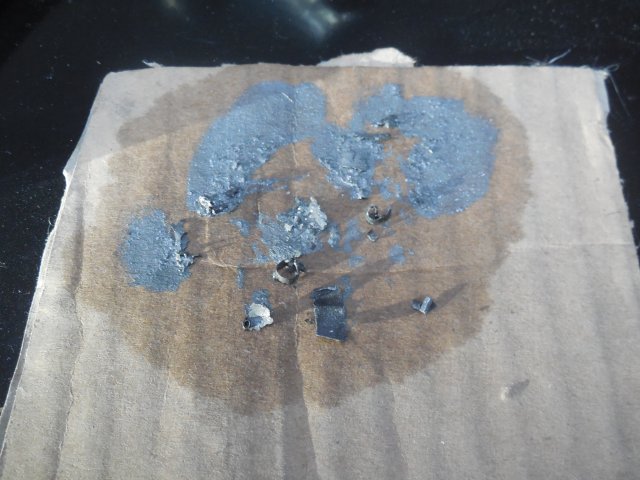

People sometimes give me crap for not driving a new (or new to me) vehicle until I've checked all fluid levels and that all fasteners are tight, or at least present. I pick the vehicle up, then it goes directly from the trailer to the lift.
As I'm checking, magnetic level plugs go into everything that doesn't already have them. Then the engine and diffs get new oil at about 500 miles to get rid of the break-in crap.
In the past six or so years, the only vehicle that had all correct fluid levels was the Durango I recently bought. Well, except for the engine, which had a bit too much.
I'd put new fluid in your diff, then change it again after a few hundred miles. After that, keep checking the magnetic plug.
Hopefully you'll see less debris on it after another 2,000 miles or so.

Believe it or not, but it takes a lot less time to check and fill up fluids as needed than to deal with the potential consequences. Plus, I hate noisy gear sets.
Not that setting up new gears is rocket science, but it's not all that fun either. Still kicking myself for not changing the fluid in this one at 500 miles as usual, but letting it go to a bit over 1,200. A few fluid changes and multiple cleansings of the magnetic plug later, it's thankfully still alive, if not as well as it could've been. DSCN0843.JPG
