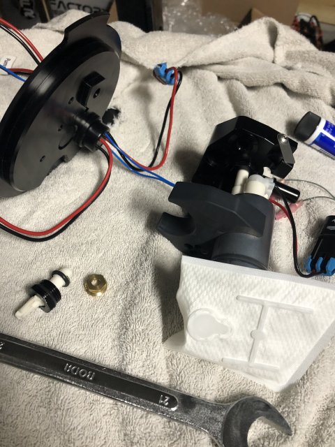

Pump came in. Got it all put back together and did a little test drive and things are running great so far. I’ll log some WOT tomorrow. Man what a relief!!

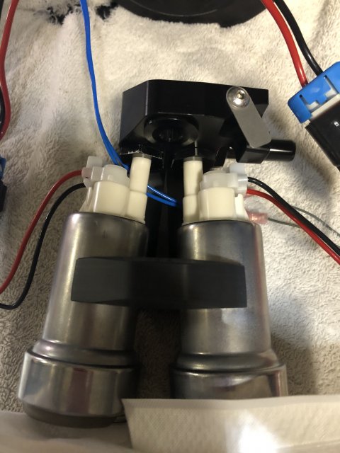

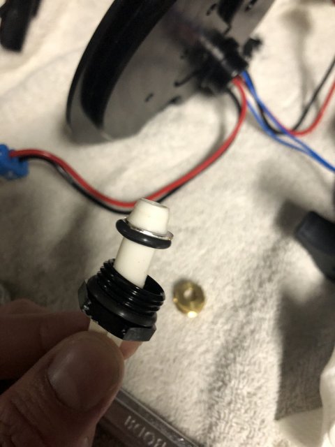

In case anyone is wondering how these go together, it’s just an oring and c-clip in the groove of the nipple. The brass hex fitting threads on bushing which threads into the manifold. I can see how these nipples can crack if the pump’s not lined up perfect because the bracket holds it pretty damn tight. And btw the replacement pump had two stabs in it too:unsure::LOL:

Not actual stabs, but those little indentions in the left pump ^^^^^^^
There were 2 in the cracked one and there were 2 in the replacement....
