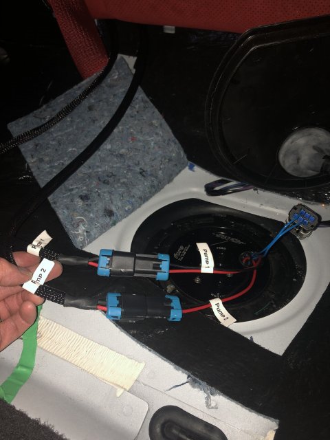

I’ll check and listen, but how can it be wired backwards? I can only see one way to wire it.

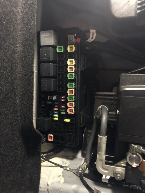

power on corner post of fuse panel
2 grounds on factory post beside fuse panel

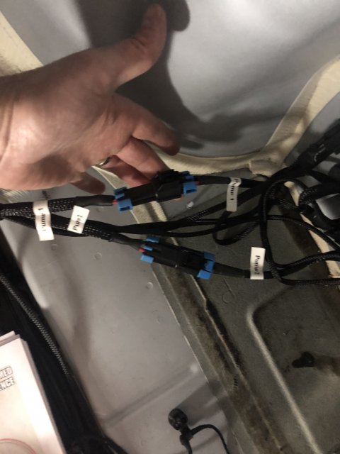

Fist and Second fpdm and y harness only go together one way I’m pretty sure
pump 1 and 2 wires clearly labeled all the way to the hat.

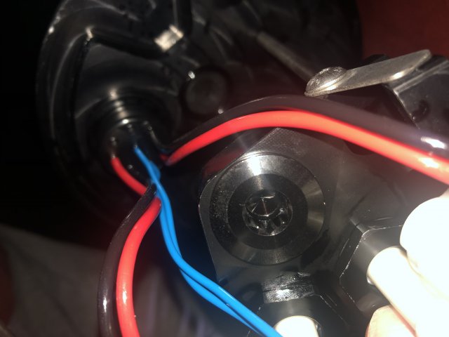

wiring connector on the hat

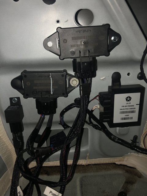

Checked the wiring again. Seems to be correct. Excuse the mess, I didn’t secure it all down yet because I wanted to make sure it was working first. The primary fpdm is the one with white line on it.

Looks similar to what @Speedy! installed. He has a video on youtube that may help

I've seen both parts several times. Great videos. He did real good job with the wiring. Maybe he can chime in
