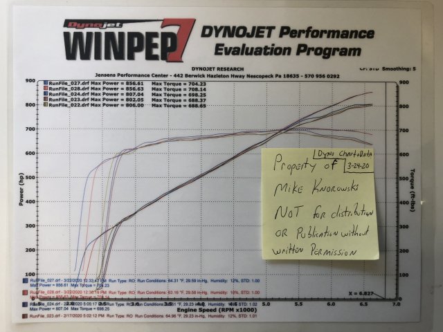

Ok, after MUCH ado here’s the results

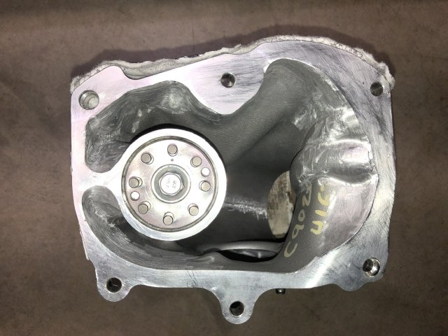

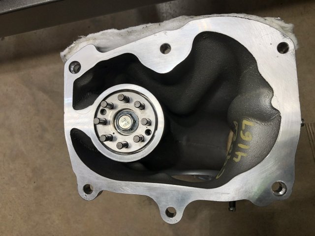

FAS Billet plate, port matched my snout to the plate inlet, Fastman 95mm TB. Before and after, dyno 2/17/20 3 pulls, dyno this past Sunday 2 ditto pulls, no other changes, didn’t even disconnect the battery or do a throttle relearn. Look at that baby breath now in the top end. Added 2-3 mph to the top of my 1/4 runs

Thread Starter #272
Hey can’t see the numbers how much did you actually gain hp & torque???

Here’s a pic of what needed hogged out of the stock snout, only took about 2 hours with a die grinder.
50 solid HP and about 20 ft lbs tq but more impressive then the peak numbers is the area under the curve difference of both after about 5300 rpm
I posted a pic of the dyno graph did it not come through?

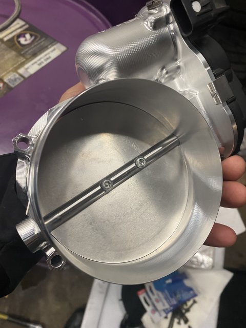

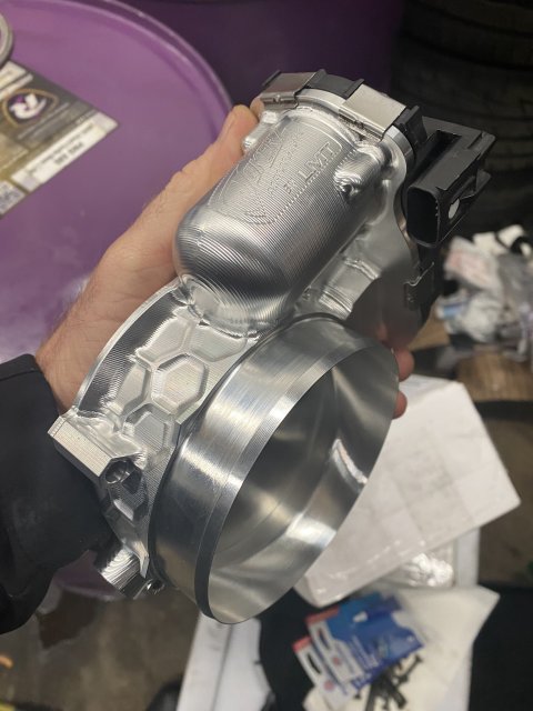

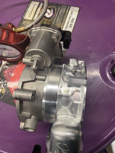

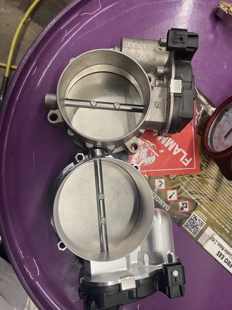

Look at this jewel it will swallow the stock one EEAA7BAF-CC51-46BE-904D-D33682C8310A.jpeg 8AB58E29-AFD7-4F4C-B26F-4A3DAA5FA6E6.jpeg 295C942E-D6A5-44DF-8E27-EAB38D29B75C.jpeg 984BB87A-2ADD-4255-BBC7-F5D6B832499C.jpeg
5,210
9,669
WOW , & gosh damn that big ! ….that's what she said. :LOL:
That looks nice !

Man that definitely is one big ass throttle body!!
