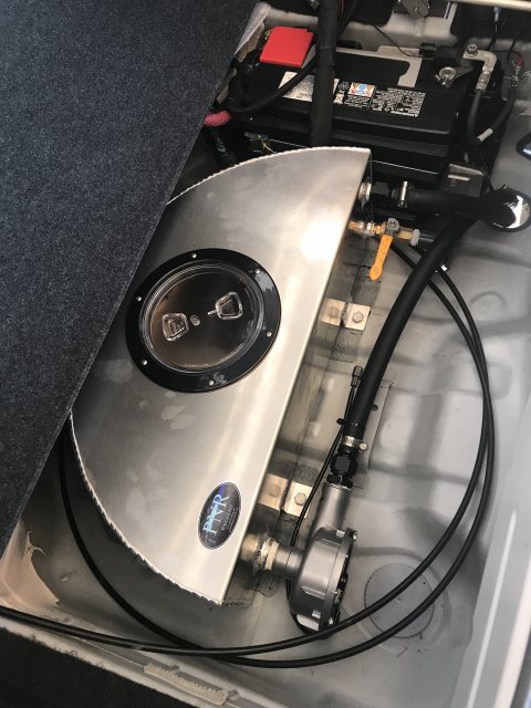

Yes. The ice tank is a huge help for something like this. When I made a pass with the tank topped off with ice (all seven gallons) on top of a interchiller cooled half tank, I saw IC temps in the 30’s with the full tank good for the whole half mile. IAT topped out at 120 on that run. On my last pass (out of ice) just using the interchiller, the IAT peaked at 160. If by motor you mean pump.... my EMP tank has the big outside pump on it and the stock IC pump has been removed.
So I can run the ice tank as a regular system on the street. Just get the stock pump removed and buy the EMP pump? I think SRT installed yours. Now that they have done yours maybe they can do mine.
Me to AlleyCat. It’s just to dam hot here on the west coast. I plan on getting one when ever I can get my car down to Tommy.

With SRT doing Marc's which means they have the procedure down can they do it while you wait? Or do they need two days? They have one for the trunk that is 8 gallons if you do not mind removing your subs. I never use my subs as i have a rubber mat over the carpet in addition to the skinnies, jack, etc. in there.
Lethal performance has a 8 gallon one. Fits in the trunk. They have a Rule 2000 pump or you can upgrade to the EMP pump. On the Rule 2000 pump other forum members used to have problems with it. Then they found out by taking out the original pump it worked better.

You want the EMP with the big Davies Craig pump. You can bypass and remove the OEM pump. You have two choices in tanks. One sits to the side so you can keep the subwoofer. The other sits in that space. You can’t seriously run one of these things in the Southwest heat without additional cooling. The stock Hellcats were having problems just getting down the full half mile due to IAT limits. They can do it in one day (all day). 4F2DBDE9-3E6A-4695-BCDC-FCBC5AC3E43C.jpeg

You want the EMP with the big Davies Craig pump. You can bypass and remove the OEM pump. You have two choices in tanks. One sits to the side so you can keep the subwoofer. The other sits in that space. You can’t seriously run one of these things in the Southwest heat without additional cooling. The stock Hellcats were having problems just getting down the full half mile due to IAT limits. They can do it in one day (all day). View attachment 4654
So I literally do not care about sub woofers. I have so much stuff on top of them that they do not matter. Where do I order the Davies Craig pump?
Buy the whole setup from EMP (Extreme Muscle Performance).
Got it. The emp pump is the Davies Craig pump.

Marc,
should i order the charger one since i will be taking out the sub woofers/
are you going to be at whp on friday and saturday or just saturday/

Marc,
Yes. They call it the Charger version. That’s the one I have. We are replacing the thermal spacers with Cometic gaskets. We’ll have those tomorrow so we should be back up and running for the Friday night event wherever that is and then race the quarter mile at WHP on Saturday.
