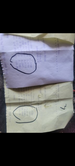

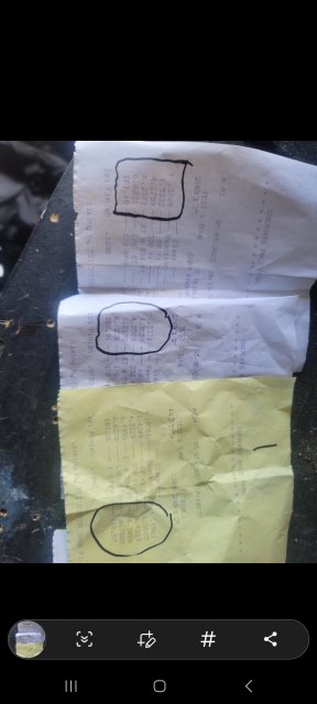

Thread Starter #80
Slips from last night. 1/8 miles Screenshot_20230506_133129_Gallery.jpg Screenshot_20230506_133126_Gallery.jpg Screenshot_20230506_133126_Gallery.jpg
